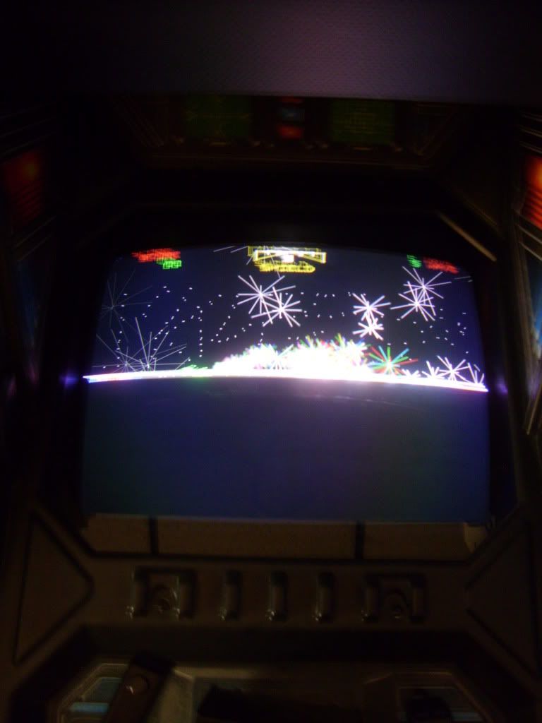

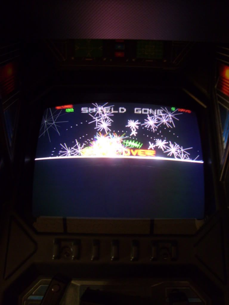

The bottom half of my Star Wars Amplifone Monitor collapsed tonight. top half is perfect. Any ideas where to start on the Deflection board? I will post a picture.
here are some pics.
Just replace all 4 bottle cap transistors. Then when you're done with that ensure both HV and deflection boards have been bullet proofed. If not do it and add a fan or two. I believe L42 had a thread on it long ago.
Im going to order the transistors, and do the other mods.
I went in to look at it again. And the picture was full?? WTF?? Turned it on and off picture came up full?? Cold solder?? or could it still be one of the transistors going??
could be the x and y pots on the deflection board ... next time you lose deflection, exercise those pots ...
