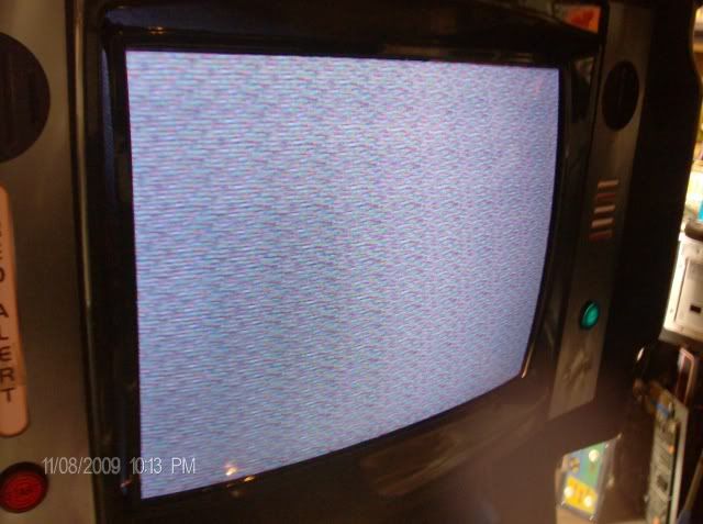

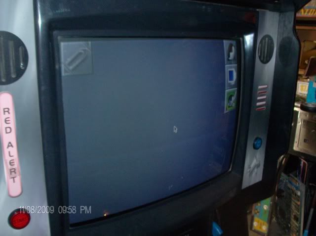

Heres some pics I took. Im sure the monitor is ok judging by the first pic. Im just wondering where to start. Theres a complete board and hard drive set on ebay for 400, and Id rather find what I need than buy a whole set for 400, because Ill part mine before i drop that much coin.
The first pic Ive only got that screen twice. Usually its the second one.

Is this a PC based game with a JAMMA adapter plugged into it?
I've seen the first screen before with Police Trainer 2 when there were problems with the JAMMA adapter board that plugged into the parallel port of the PC. One had a corrupt CMOS thanks to a dead battery and the other had burned traces on the JAMMA adapter. They were booting to a Linux desktop of some kind since they couldn't read the security chip.
Both were fixable. The CMOS settings needed to be reset manually as the system's default parallel port setting wasn't compatible with the game.

Hook a keyboard and VGA monitor up to it and you'll find that squiggly stuff is a boot screen.
These are from my notes from the PT2 board:
Replace the CMOS battery and configure the CMOS settings are as follows:
Standard:
Drive A: NONE (default is 3.5" 1.44Mb)
Halt On: NO ERRORS (default is All, But Keyboard)
Advanced:
Anti-Virus Protection: DISABLED (default is enabled)
First Boot Device: HDD-0 (Default is CD-ROM)
Integrated Peripherals:
Onboard Parallel Mode: EPP (default is SPP)
Power Management Setup:
Video Off Option: ALWAYS ON (default is Standby -> Video Off)
State After Power Failure: ON (default is Auto)
Changed battery, reset and changed the bios and getting an IO fatal error 104. My buddy thinks somehow the drivers were erased.
Make sure you set the CMOS correctly... then double check that the board didn't come partially unplugged from the parallel port. After that, rotate the button cell (security chip) in its holder a bit just in case the connection has oxidized.
