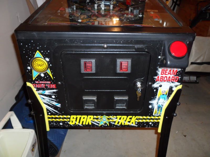

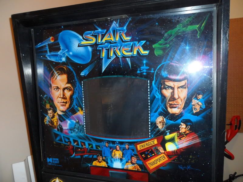

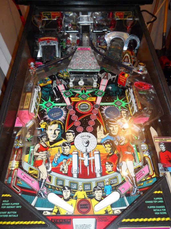

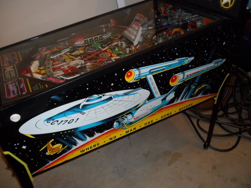

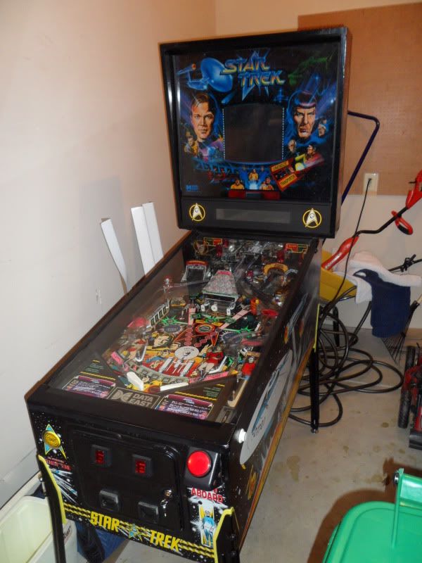

Picked this up at a VERY good price, imo. It's in terrific shape. Not a single scrape or gouge on the machine. Here are some preliminary pics. Will post better ones when I get it inside and cleaned up. It's been shopped and looks immaculate! Playfield looks brand spankin' new. Only real issue is sometimes the ball can't get kicked out into the plunger channel. It takes up to three times for it to get kicked out. I haven't looked into the issue yet...

For the kickout problem, I have had the same issue pop up on my Jurassic Park. I find that sometimes the steel arch that the balls ride up against (which curves to kick them into the shooter lane) starts to sag or droop a bit. Lifting up on it to create a bigger opening for the ball seems to help a great deal.
Also, make certain that the ball to be kicked out sits squarely over the coil/kicker and that there's nothing else obstructing smooth motion of the coil.
