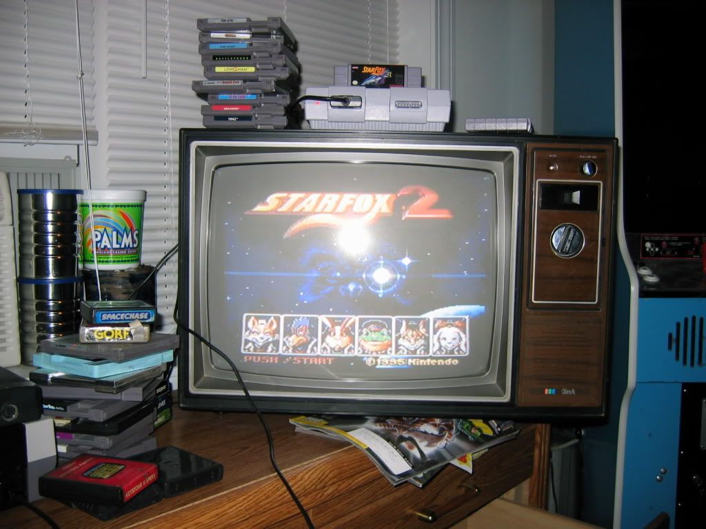

Finally took the day to have at it and it was a success.
The game is beautiful! NTSC USA!
Excuse my de-cased snes. It's just floating their on a book.
It's a parts snes that I just fixed today.
For the fans who might want to get their hands on this Ill sell this cart for $50 shipped.
It took some time to put it all together.
All assembled in a clean manner... those wires are not going anywhere

What was the donor cart, Stunt Race FX? Where did you get the EEPROM programmed?

I made one of these for myself last year sometime. It's actually a pretty good game. I don't know why they never released it. Chad, what did you use as a donor - Stunt Race FX? That's what I used, and I haven't had any noticeable slowdowns playing the game, it all seemed fine to me. Supposedly the game was written to use the FX2 chip, which was never released, but was just a faster version of the FX.
And yes, I know, pics or it didn't happen:
I built mine with a DIP EPROM just like you did - it's a lot of work and lots of tiny soldering. Definitely a good idea to go with a surface mount part that actually fits on the board if you're doing more than one :)
