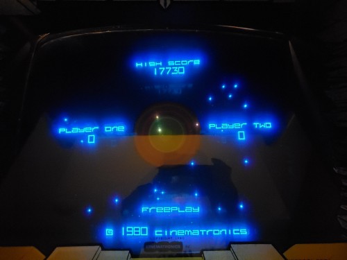

Been playing a lot of Star Castle today.
Look what just happened ... I'm getting skillz ... :)
NOTE: screen shows high score saved after game turned off, waited, and turned back on. (this is the new unreleased HSS/FP/AM ROM version too) :)
