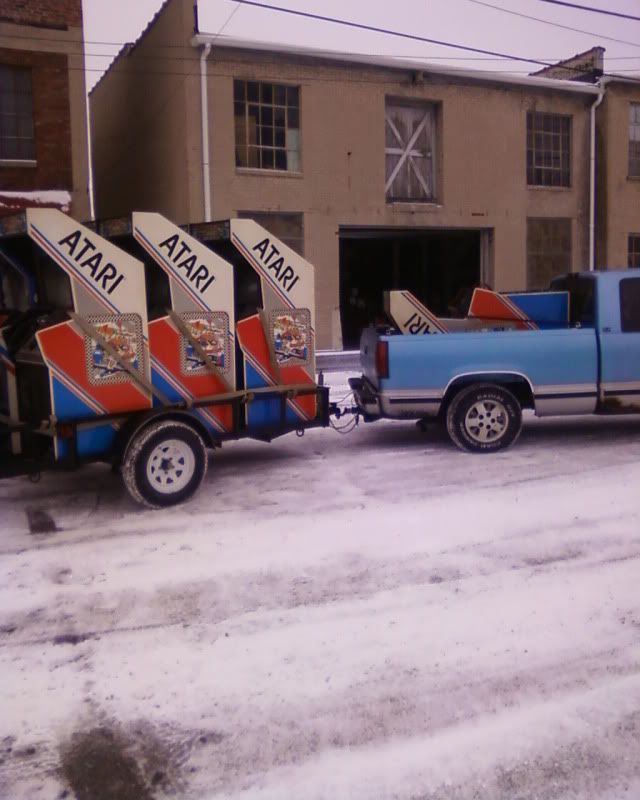

I do it almost every day. I have had no issues. I usually leave my Refrig dolly strapped to the one against the cab and put a strap accross it to keep it from toppling. then keep putting more up against it. No big deal. Keep it under 100 mph and you should be fine. I stand them up on my trailers also. Have not lost one yet.
Here was one last week.
Lash 'em together pretty good if you stand them all up...

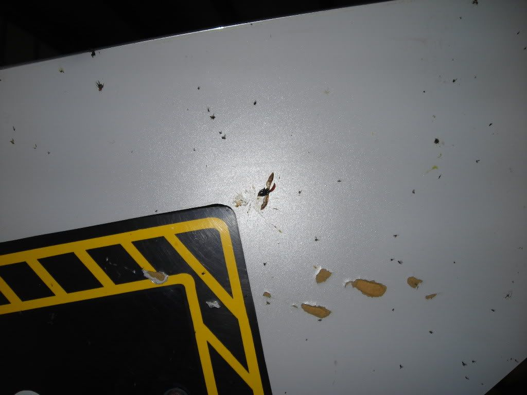

One more thing--if you are moving a game with good artwork, watch out for bugs/tar/rocks/etc. Some plastic wrap (the green stuff you can get at Uhaul stores) works wonders. If you can't cover a game up, you can face it backwards, which should provide some protection to the front and sides. I'd rather have a chunk taken out of the back door than crack a marquee.

And since we're posting pictures:
