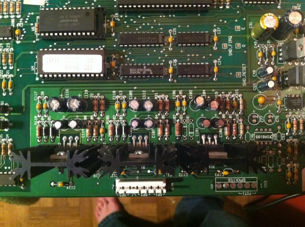

Hey guys im having a bit of a problem ordering some resistors not sure what ones to order as the values in the guide dont come up on mouser probably becuase im retarded.
Can any help me get some part numbers so I can order this stuff up?
Resistors:
R19 (100KΩ ¼W), R100/102 (22KΩ ¼W), R101 (470Ω ¼W), R103 (1Ω ¼W)
Thru-hole or surface mount?
Thru-hole Mouser part #s:
R19 (100KΩ ¼W): 71-CCF55100KFKE36
R100/102 (22KΩ ¼W): 71-CMF5522K100FKEK
R101 (470Ω ¼W): 71-CCF07470RJKE36
R103 (1Ω ¼W): 71-CMF551R0000FKEB
Not the cheapest... these are Vishay metal film resistors. They are considered "flame proof" and if they go out, they don't burn things up badly like the carbon ones do.
Parts here today! Now I just need a spare speaker can I just use one from axeman I dont feel like waiting for it to come in the mail.
Before & After
Looks like it's missing two diodes (D100/D101), a screw, insulator, and nut on the amp heatsink.
Yeah I forgot to order the diodes but somehow radio shack had the correct part #. The nut and bolt were added before I installed it.
I didn't notice an insulator on any of the amps unless there is something in the pic I'm missing. Speaker fired right up.
