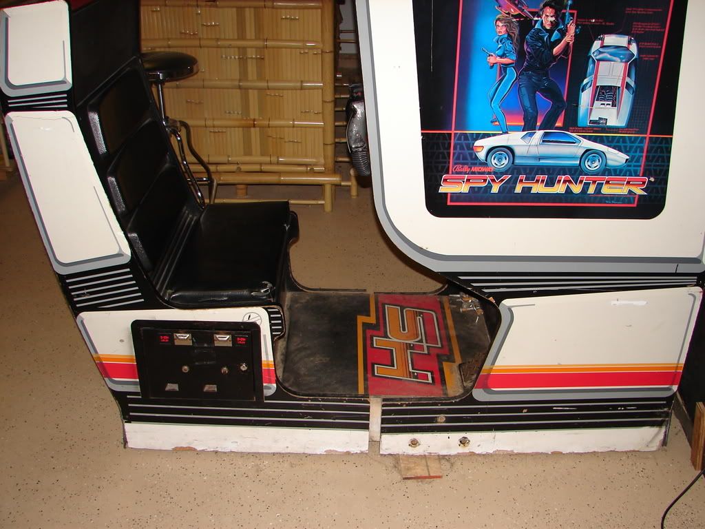

Can somebody please confirm that Spyhunter cockpit does indeed come in 2 pieces that can be reasssembled? I checked the manual but it is very sparse on details. I cannot lift the sucket to check but did notice that there are several bolts on one side of the cabinet near the base that appear to be "hold together bolts"
Difficulty level?
Thanks
yes the seat section and the main section (monitor, controls ect) come apart. Moving one is not too different than moving a regular game.
You need to pull up the floor mat
there are 3 bolts on each side, on the side not under the floor mat(metal peice with SH painted on it).
And after removing the 3 bolts on each side you will slide it apart ONLY far enought to un do the wiring connectors
you can see the bolt holes in this picture with it slid apart about 3 inches
also the floor "mat" is there, it just lifts off, seat end first
