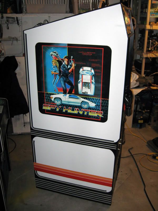

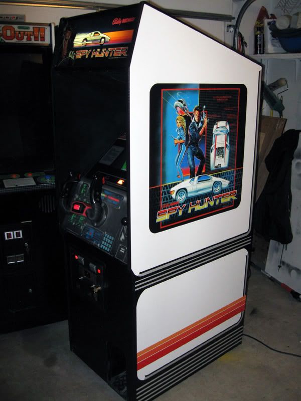

Well... I finished the Spy Hunter tonight. While not perfect, the left side went on quite a bit better DRY than than the other side did WET.
I've also had some time to really consider the situation. I'm an anal bastard and I think a lot of my ire is because I am such an anal son-of-a-bitch. After taking a step back and re-evaluating the situation I've come to the conclusion that the right side is acceptable... at least for now... it still looks SOOO much better than it did before I replaced the side art...
Here are some comparison pix:
...and some final pix...
