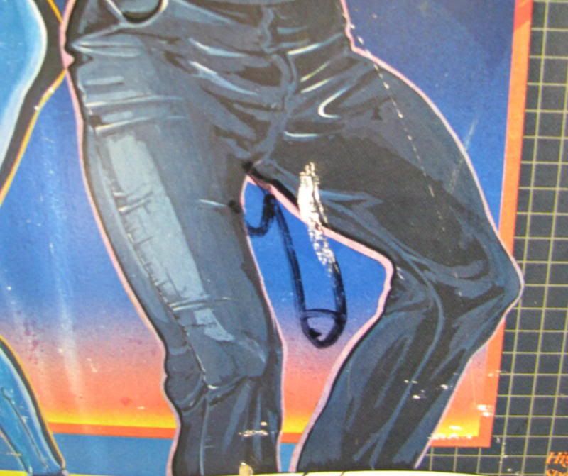

"80s arcade working Spy Hunter game with original graffiti. The scrawled-on dick is original and not repro. Will sell or trade for Spy Hunter cockpit. 80's era Bubble Yum smashed into speaker grill included."
Can I get a high res pic of this? I wanna blow it up and frame it in my arcade. Awesome.
Man, I laugh every time I see it.
I think it's the dude's pose that kills me. It's like he was involved in some serious physical action, has just put his heelie brakes on and *BOINGGGG*, out popped the Salivating Cyclops.
Is there a reason the dudes dick would just be hanging on the outside of his jeans like that? Where the hell is it coming from? Ahahahahahahaha.
Ahahahahahahaha, it's like it's coming from behind him. His left leg is in front of it.
Ahahahaha, seriously. Its like in Silence Of The Lambs. Dude has a massive tuck going. That thing is going to hurt someone. The head is almost touching his calf for fucks sake. Ahahahahaha.
Check the schlong, then scroll up and look at dude's expression. Ahahahahahahahahaha, "you like this?" He seems to say. Ahahahahahhahahaha
At least we finally know why he is "posing" like that with his legs. Poor bastard.
