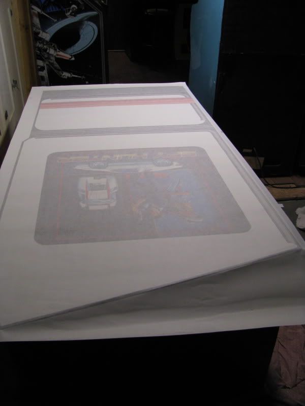

Cab lying on it's side, started in the middle and worked down, then middle to top. I cut about 4-5 two inch notches around the top and put painter's tape in the notches to hold the art down (taping it to the cab is what I mean) while I applied it. Mrs. Cartouche helped me, as you know, it's a pretty big sticker.
positioning the art:

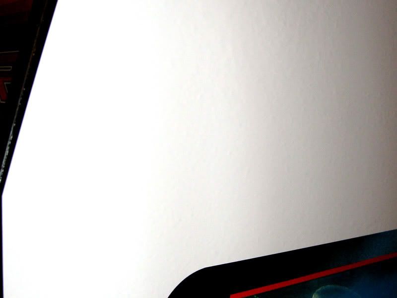

see the notches around the top, that's where I taped it into place

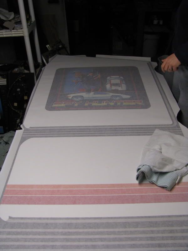

starting from the middle:

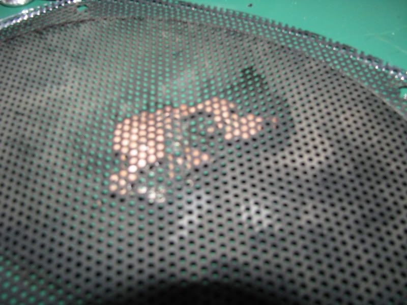

now I just need to clean this 25-year-old gum out of the speaker grill:

I taped the top half to the cabinet at a few places around the edge. See the second photo at the top of the cab? There's a little tab I cut out so I could tape it without bending or folding.

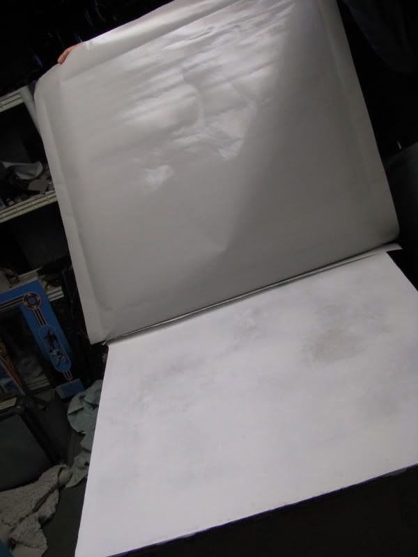

Then with the top half securely taped to the cab, we lifted up the untaped half, peeled the backing to the halfway point and cut it off with scissors (photo 3). I held the side art up, again photo 3, then lowered it slowly as Mrs. Cartouche smoothed it down with a clean rag, working from the middle to bottom of cab.
Once the bottom was stuck to the cab, I took off tape at the top, peeled off backing, and repeated. Again from center to top.
I've applied full side Centipede art, full side black and white vinyl, Sys 2 side art, and this is the easiest and smoothest it ever went down. No peeling back for any trapped bubbles at all. In fact, at one point, I said aw, shit, there's a big bubble, but it turned out to be between the art surface and the protective film/sheet over it. I'm not going to peel off the protective layer until it's in it's final spot, but it looks and feels really smooth.
