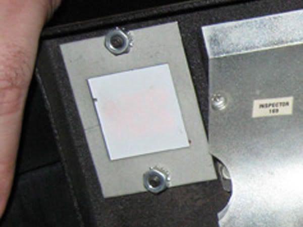

I can now move on to the last couple things I need to do to this cab. I have side art coming... I need to remove the old nasty ass side art... remove the sticky mess that I am sure will be left over... fill a small hole on one side... fill the button hole on the front where the prior owner (or before him) had installed a freeplay button... and the last "mechanical" thing I need to do is find (or make) a 25 cent insert bracket for the coin door...
...if anyone has an extra 25c insert bracket, please let me know what you'd want for it shipped to Nampa ID 83686. It's essentially a piece of metal with a square cut out and a couple of screw holes.
Looks like this:
I may have one. PM me so I remember to check when I get home.
How's free sound for price? (I could just stick in an envelope with a couple stamps don't ya think?)
