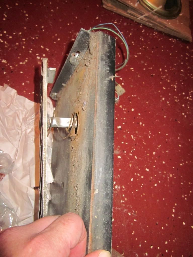

The right side pedal on my game had a broken spring, causing the car to not slow down as quick as it should, and overall it was a crappy experience to drive the white car as the pedal was quite spongy as well. Instead of just replacing the spring I used an entire replacement pedal assembly, and I will fix the old one later. The assembly is held in with 2 bolts that are accessible from the back of the game.

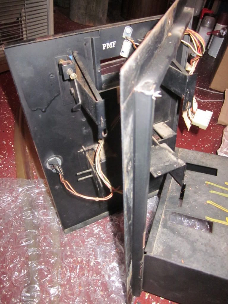

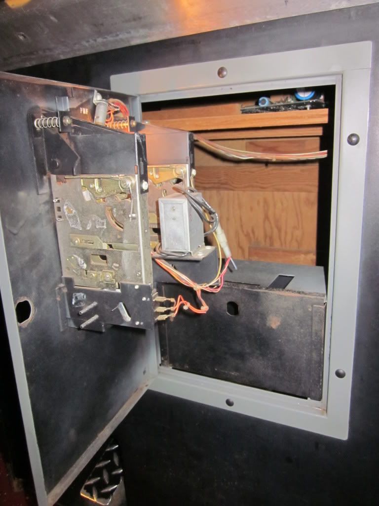

My coin door wiring was hacked up to a free play button (I hate free play), and the assembly was missing the coin box. The replacement one from super56K like I said is unhacked and includes the coin box, but the door is in primer. Plugged in just fine and works great after a light cleaning.

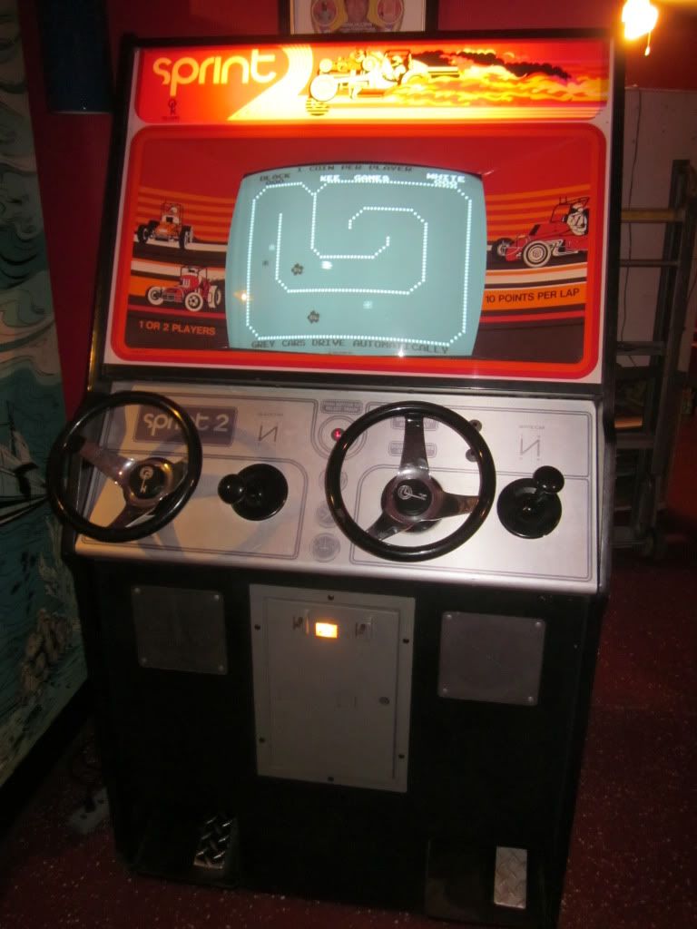

Next year when it warms up again around here I will remove the coin door assembly and BOTH pedal assemblies for sandblast and paint. For now they don't look really good, but they are functional and the game is ready for my party on the 20th. Man I love the sound of coins dropping in the bucket!
Broken spring on old pedal assembly
Old coin door with hacked wiring to free play button
