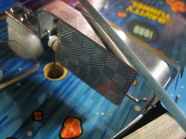

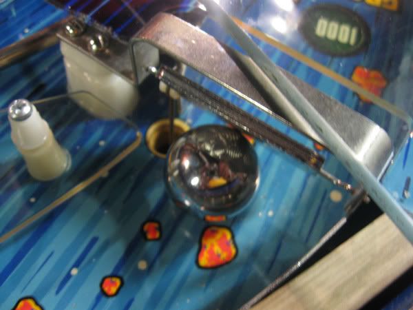

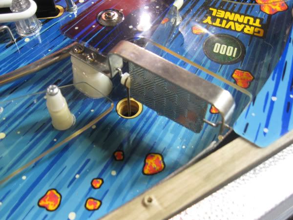

So, I'm having this issue with the spinner on Black Hole. The trouble is that on a weak shot that doesn't go all the way down to the lower pf, when the balls drops back it gets stuck on the spinner. Basically it can't push it's way back through the spinner going down.
I took some pictures of the area. The odd thing about this whole game is that the playfield is pretty close to the glass towards the top, and right now the glass actually slightly pushes down the spinner assembly as it goes over it.
I've tried adjusting the spinner, the bracket, etc. but just can't get a 100% fix on this. If the glass is off, the ball goes through just fine. But when the bracket gets compressed down a little bit with the glass on it prevents the balls from moving through both directions.
You've got something in the way of letting the playfield seat all the way down... The glass should not touch that spinner!
I know your right, but it just doesn't seem like the pf wants to sit any differently. Maybe I can finesse it down a little bit.
