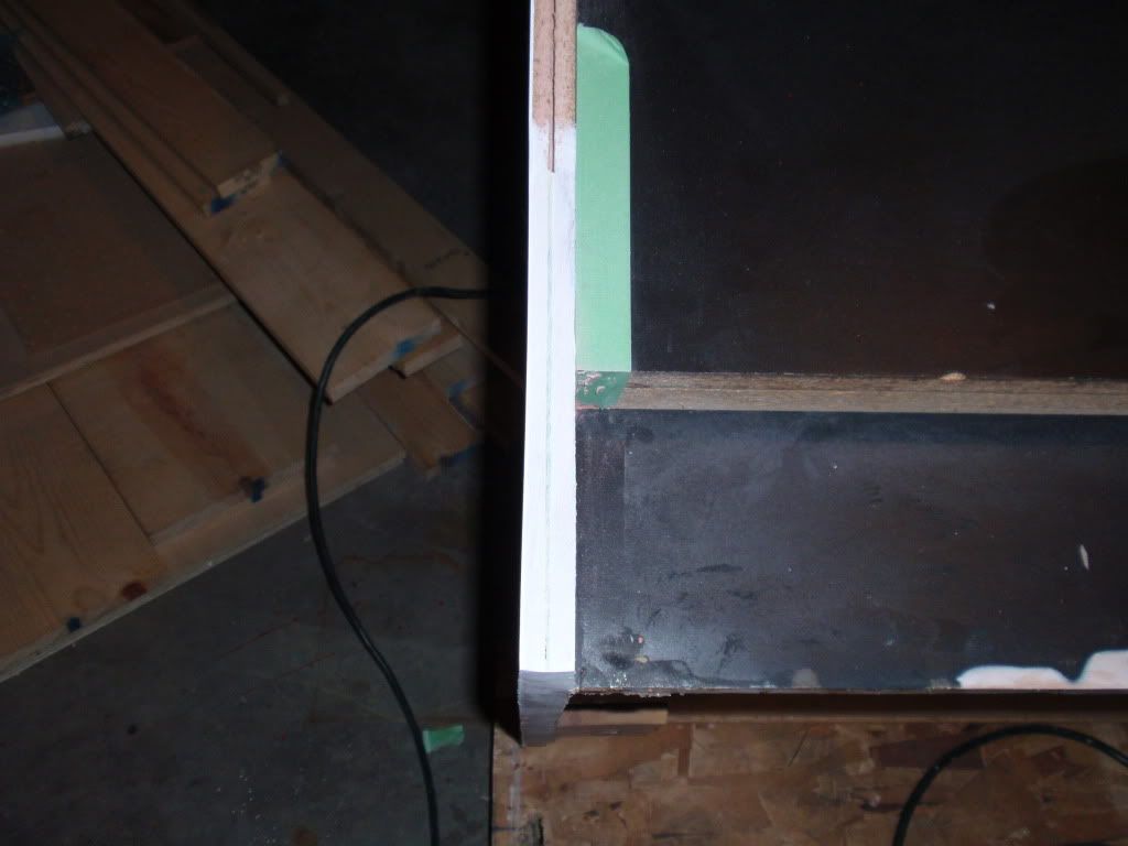

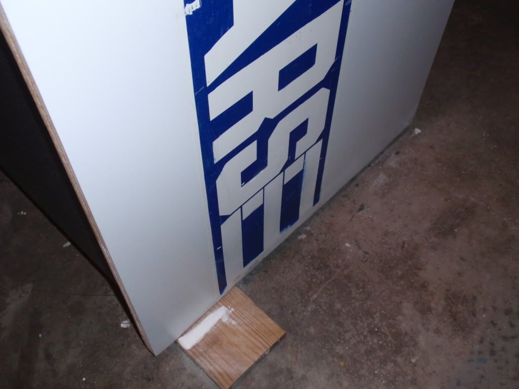

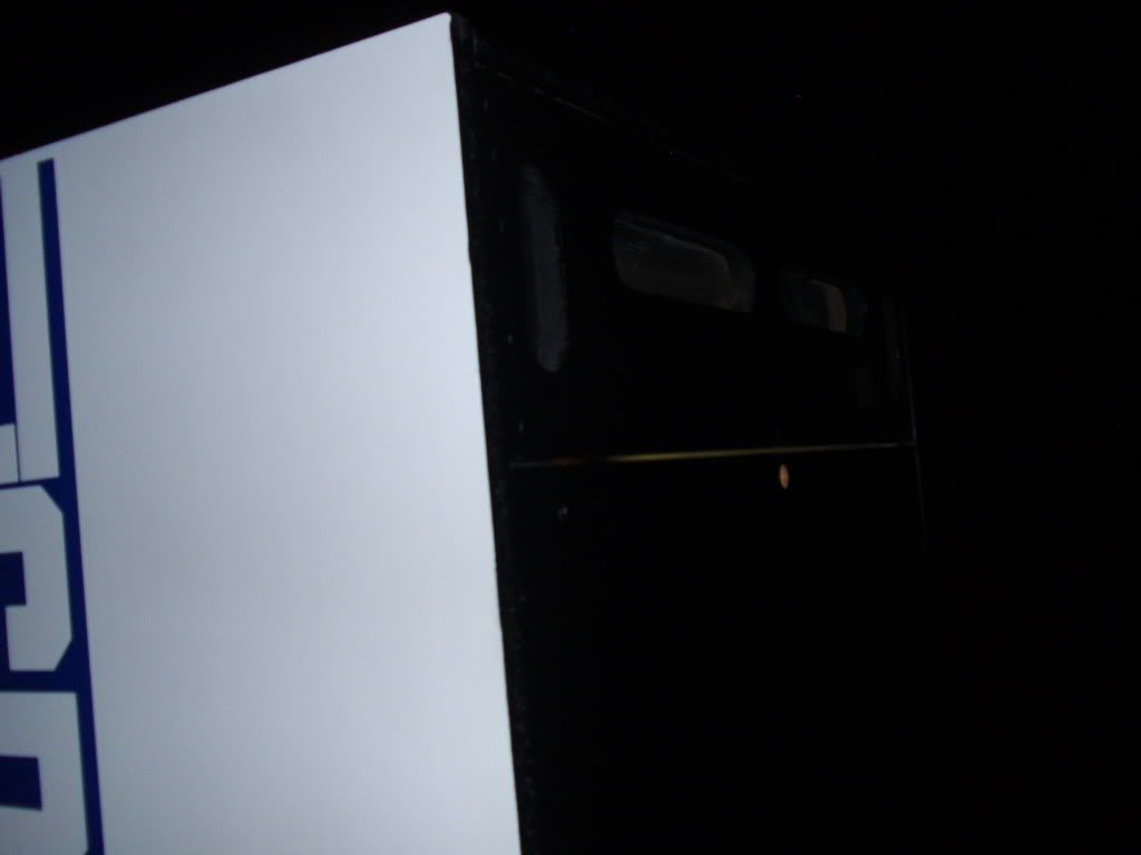

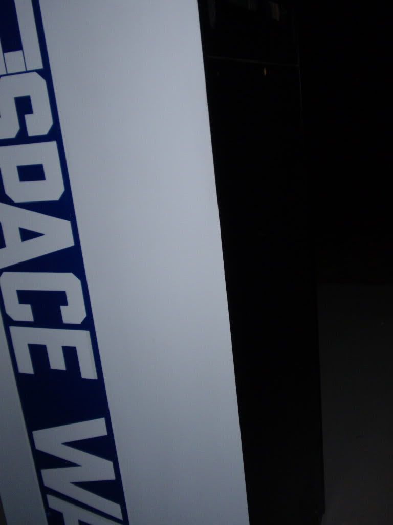

Now this wasn't a full resto, but pretty damn near. It took me longer than most for various reasons, not the least of which is that the cabinet is huge and heavy. It came to me from Kansas with a huge chunk missing from the front corner:

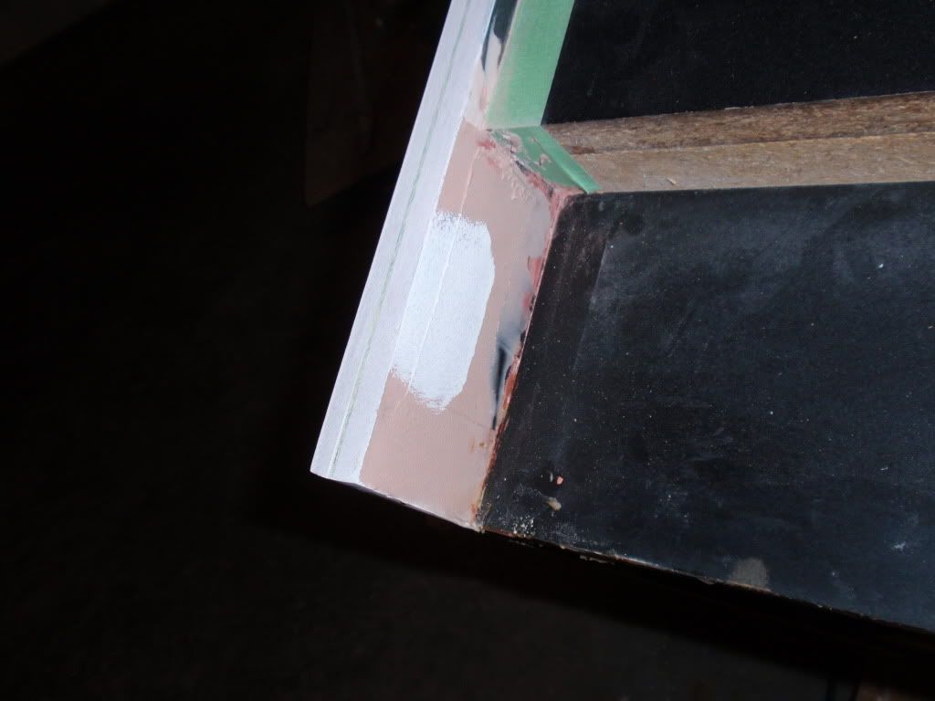

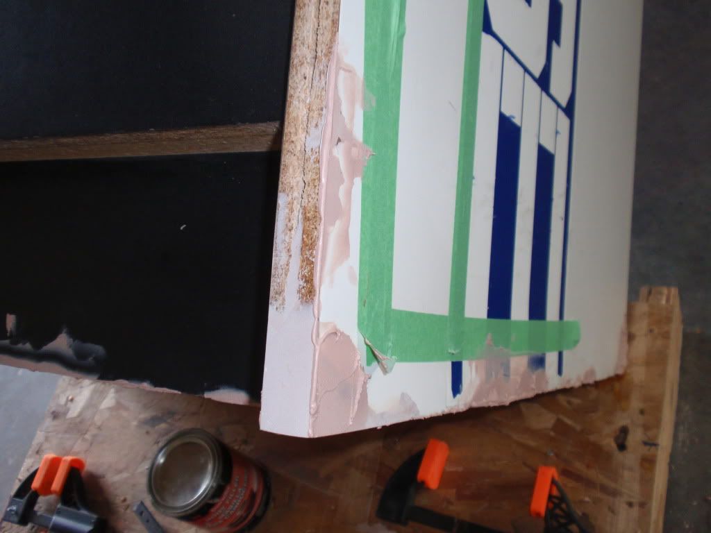

A little bondo:
And things were starting to shape up. After sanding, we were onto priming and painting.
A little paint and it's starting to look better:

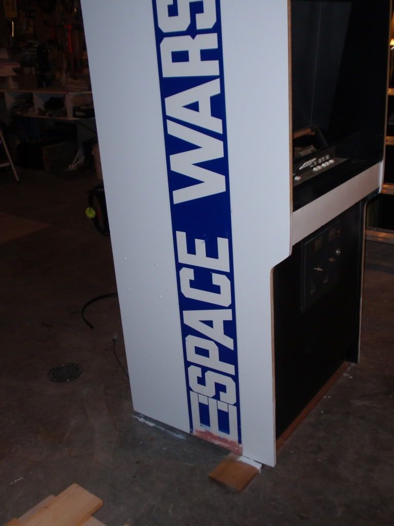

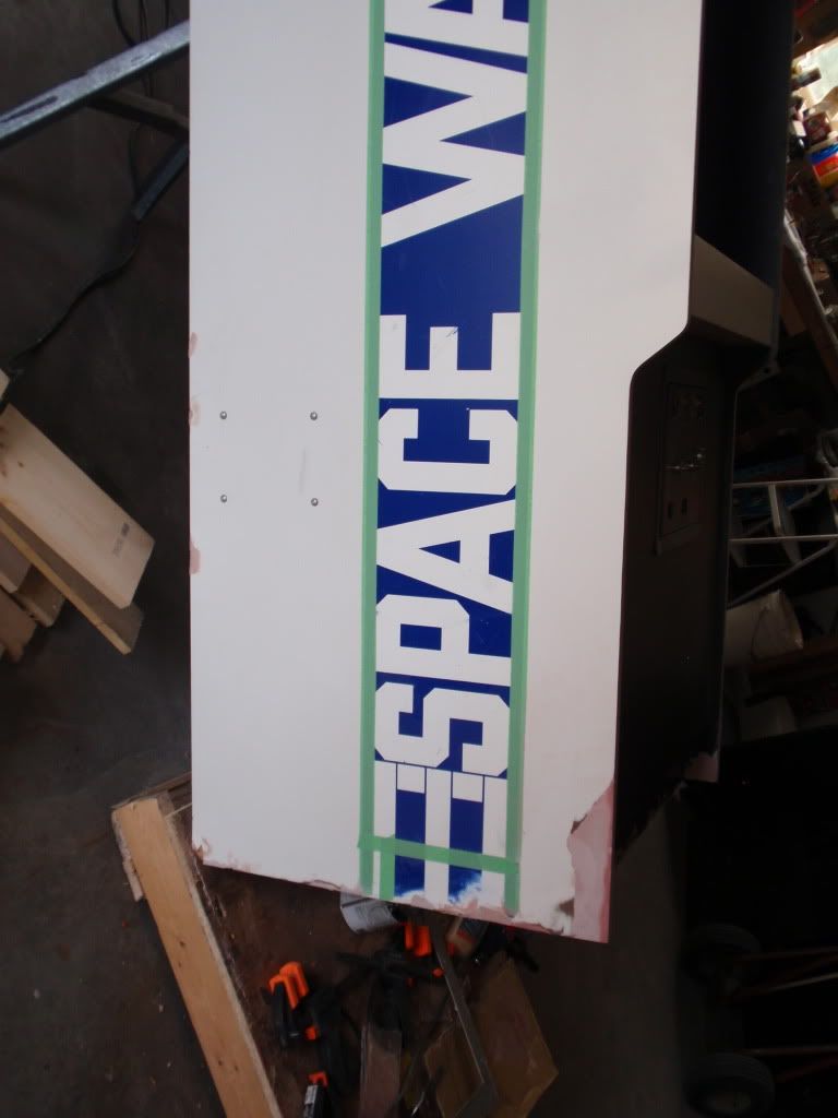

Now to add a finish coat of white, mask off the blue at the bottom, remove the blue mask, mask off the white and paint the blue, cut a t-molding channel and add t-molding:

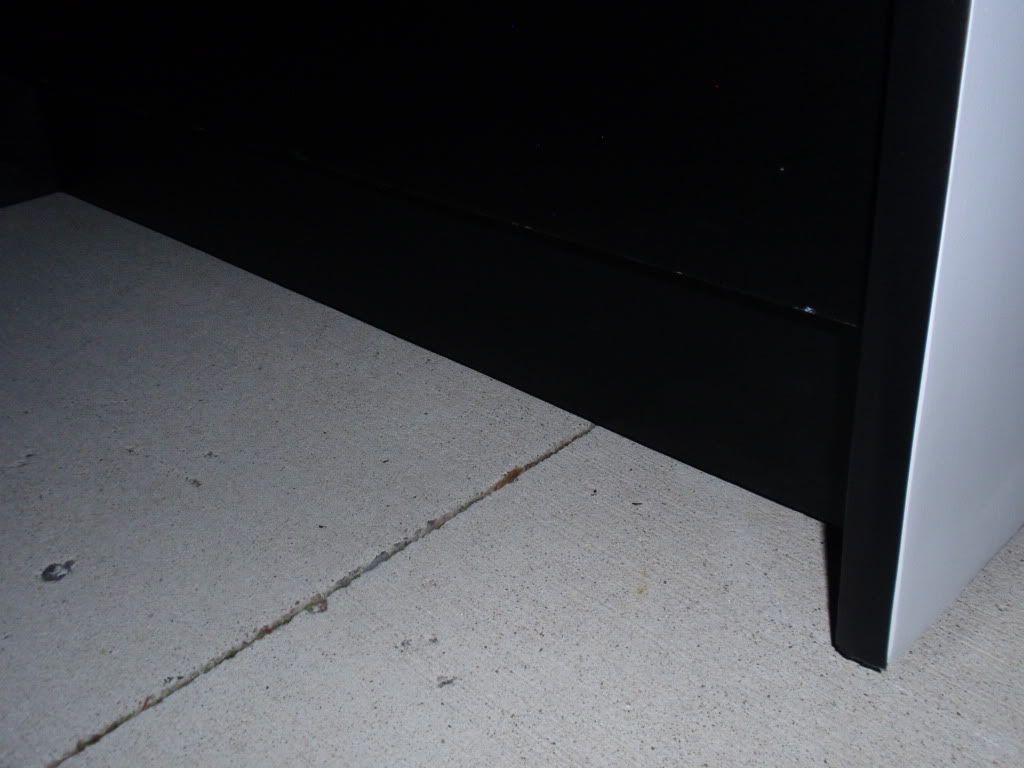

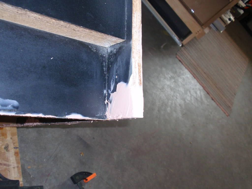

The front toe kick was pretty F'ed:
A little glue/clamping/bondo and paint, and she looks good as new:

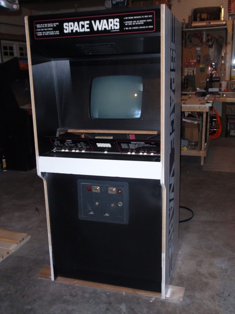

The only thing I can see myself doing is maybe getting new side decals printed at some point, as these have several scars and the paint I used at the bottom was a darker blue than my sample would have led me to believe. Otherwise, I am happy with the way it turned out. Finished Pics:
More random pics:
And just so you know, I used masking tape and an exacto and masked off and painted every stinking white letter on this side, as the decal was pretty f'ed in the white areas:

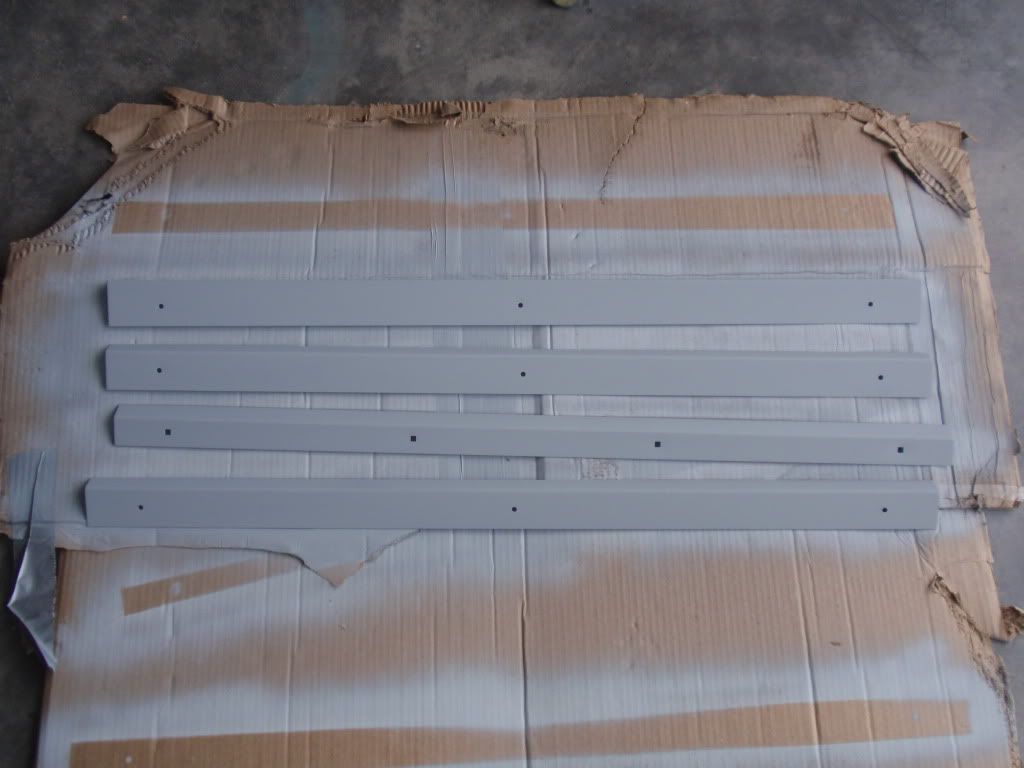

I almost forgot the rest of the list. The metal brackets, bezel and marquee, were pretty rusty but straight as an arrow.
Rather than have them sandblasted and powder coated, I used 120 grit paper on my orbital to take them down to bare metal, primed them with automotive primer and gave them 3 light even coats of Rustoleum satin black. I only have a close up pic of the primer:
But suffice it to say they look better than new now, with the proper sheen.
