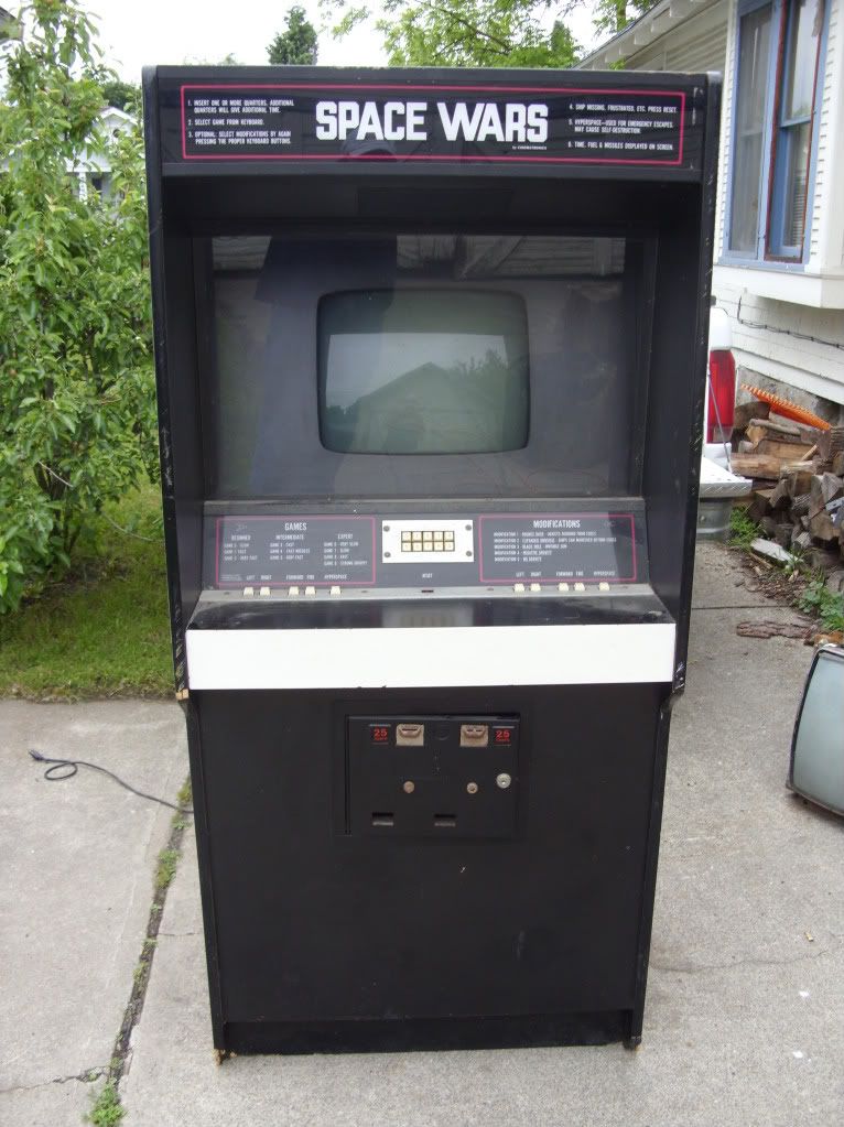

Pretty cool vector!! Hope I can get it going. All I have is neck glow.
Oh, cool find! Like the poster above said, that machine looks to be in awesome shape.
Hopefully it won't be too difficult to fix. But you know those Cinematronics games...
Great game and pretty easy to restore. Make sure you have a companion to play with, or the game kinda loses it's purpose, as there is no 1 player mode. Mine's been played twice in the last 9 months.
