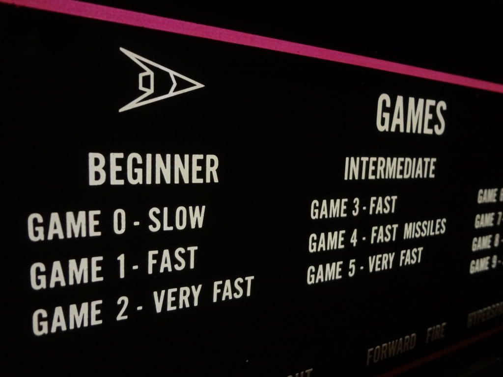

Sorry to tell you. But they are different. Cinematronics cp width =31.5, Vectorbeam =29.5.
Also many other differences. I'll upload the pics for you tonight.
Here ya go.
Pic one is the VectorBeam control panel. 29.5" long
Pic two is Cinematronics. 31.5"
The Vectorbeam curves to wrap around the front face. It also screws down into place.
