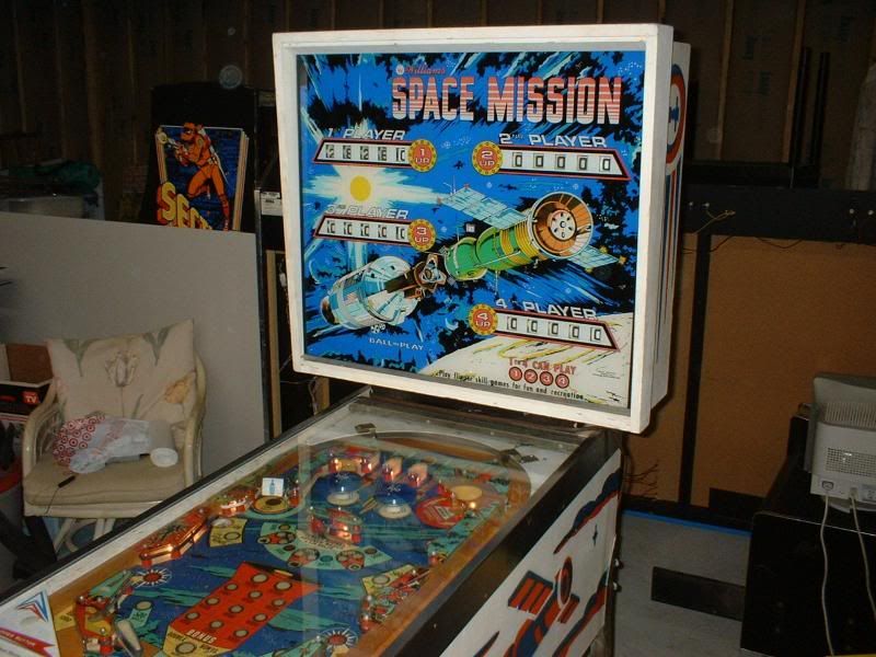

I just picked this up for $200 and it didnt work ,got it home and fixed it just now but my question is... none of the back lights work and theres over 50 by the looks of it. I couldnt see no fuse for them but just looking at the lights they all seem bad maybe couple good ones here and there. Is there a fuse some were or can they all be bad.This my 1st pin like this so im a little lost.

I doubt all the lights are bad. Yes there is a fuse for the lights in the back box, it's located in the bottom of the cabinet towards the front right side close to the chimes. I think there are four fuses there. I have a Space Misson and mine had a problem with blowing the fuse for the backbox lights. I can't remember exactly what was causing it I'll have to look through my notes, but I think it was a switch shorting out in the coin unit or ball count unit. Let me know how it turns out.

Yes, most of them could be burned out. Just pull a few of the black ones and try them in a socket you know is working. Replace the burned ones with #47 bulbs if they are #44. Only slightly dimmer and a lot cooler than the #44s.

Check to see if there is power to the sockets. If there is, the sockets will need a solder patch on the outside barrel. Old sockets usually have this problem.

Well i feel stupid...Im up and running all lights work.it was the fuse on top behind coin box...I checked it with meter and it was good but today i got new fuses in so i changed them all and my lights work now.
Dang im dumb but the meter said it was good so...
