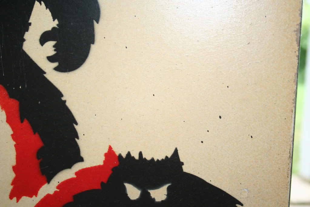

I'm curious in the differences of how much paint spackle people have on their Space Invaders cabinets. Truthfully when I first got mine, I assumed the spackle was some idiot operator painting something too close to the arcade cabinet. Then I remember reading through retroActive's Space Invaders restoration thread and seeing how he made it a point to re-create the spackle that was apparently original.
My Space Invaders seems heavily spackled, including on the wooden portion of the control panel. Do others have spackle on the control panel as well? In the aforementioned retroActive resto thread, he ended up painting his just solid black.

What part do you believe is bullshit? That Pac cabs had blue speckles from the factory? They do.
SI has black speckles on the white and extensive white speckling on the inside of the cab on the black parts.
Mine didn't have too much of the black speckles
Yep... this is accurate. I had more black speckles than the white ones on the interior... In fact I had little to none on the inside.
Also mine had zero white speckling on the control panel.
You are going to find quite a bit of variances... it's best to just replicate what you have.
I used a stiff bristle brush and flicked it about 10 - 15 inches away. I also thinned it so it wouldn't be stringy.
Practice on cardboard first.
