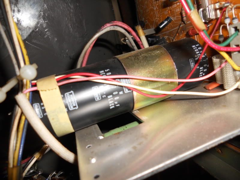

I have a Space Invaders that has these slow side to side rolling waves on the monitor. As they move, the characters widen noticeably and just in front & behind of the wave the characters are compressed. It only seems to happen on one half of the monitor, this swelling and contracting.

I had this on mine just last week. Replaced the large capacitor on the chassis and it fixed the issue. If you find any of these large capacitors, let me know, they are hard to find.
Blown-
Just to be sure, you mean this big black one, right? 50v 4700uf?
Blown-
Yours looks different than mine. Mine is a WG chassis. If i remember right its the large upright cap that is really 3 in 1.. Sorry I don't have schematics and I'm out of town right now to look at it.

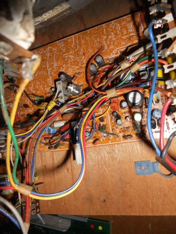

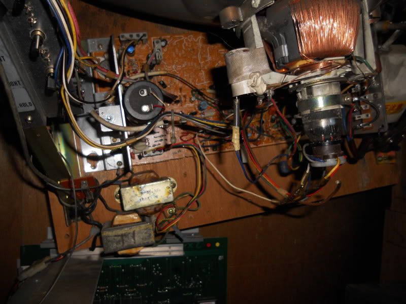

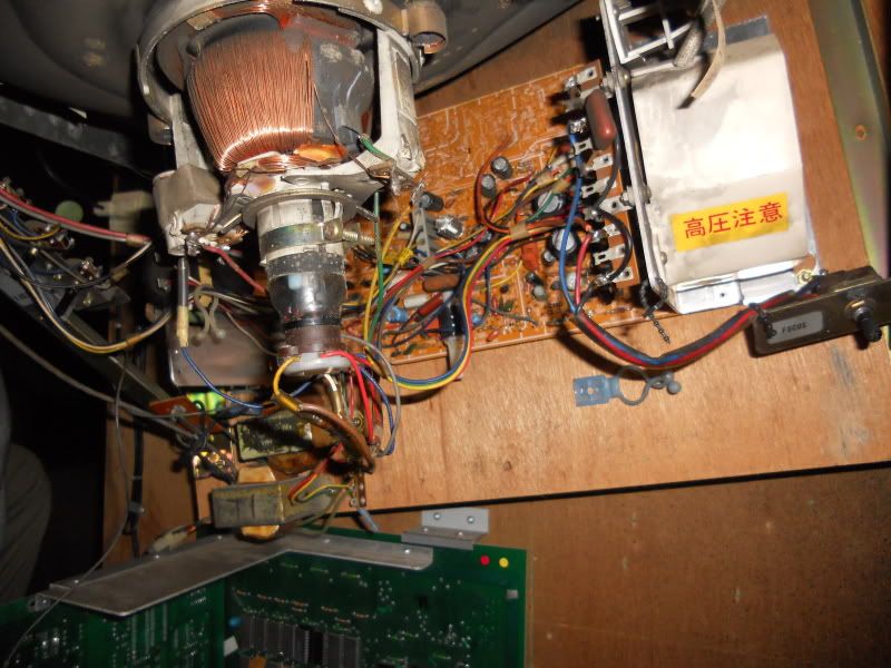

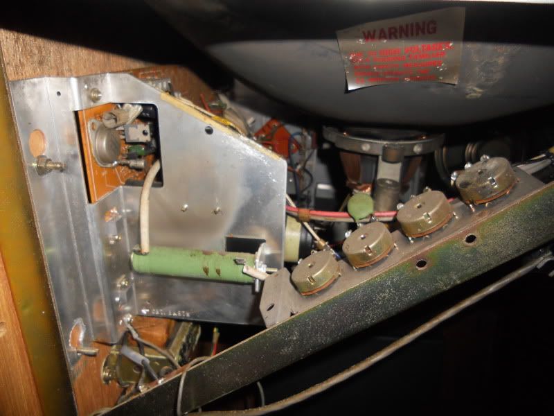

Here's some shots of the chassis and whatnot... I was hoping to avoid pulling the tube at this point... hopefully these shed some light on the matter.
Any ideas, Ed?
Sorry, it's not familiar to me......but that big black cap looks to be a single package cap. It looks to be 4700uf at 50volts. All of the other caps look original/old. Before troubleshooting any deeper, you really should do a full cap out.
Edward

I'm still on the hunt for one of these big black caps, but all I'm finding are smaller "snap in" style ones. I've seen automotive stereo systems (tricked out ones) that utilize similar sized (physical) caps, but.. I can't find anything that matches the numbers.
Is there a work-around for things like this? Is there another cap that will work? The guy who had the game prior to me did a re-cap on the monitor stuff, apparently.
A "snap in" cap would be fine for this.....just zip tie it off good, and make sure the solder connection at the legs are good.
It's difficult to tell from the pictures, but those caps (look) original/old. The black one behind the V SIZE pot looks swollen. Is the guy you got this from a friend? I'm leaning towards bull-shit on a previous cap job.

The reason I don't think it's been capped.....a lot of those caps look Japanese, especially those light green wrapped one. I've only ever encountered those on late 70's/early 80's Japanese equipment. The easiest way to tell, look at the solder side of the chassis. There should be an obvious visual difference between old/original work and new work.
Modern "snap caps" are drastically smaller than their 30 year old counter-parts. You could always move to a beefy "screw-terminal" cap (but those can get expensive...and I feel not needed for this situation).
http://www.usamusement.com/nos_list.html
I also notice that cap is stamped "Hi-Ripple".....might want to get a high frequency cap or a low ESR cap when you replace it.
