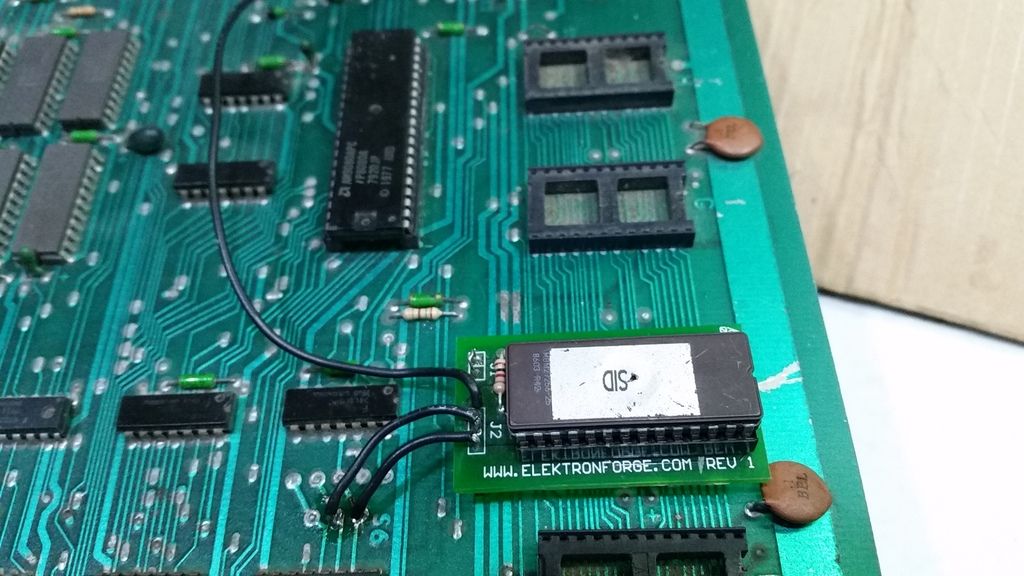

Does anyone have the installation instructions for this mod form Electron Forge?
I have swapped the it over from another motherboard PCB and believe I have done it correctly but would like to confirm from the original documentation.
Also need to confirm if the sound PCB needs to be a Deluxe or Standard (I have both).
It is being fitted into a Midway Deluxe Upright.

I know this thread is WAY old, but while going through my SI boards I came across this, and searched for a bit of info... and this was about all that came up.
Anyway, I'm guessing @Kaizen isn't still looking for this, but maybe it'll help someone in the future - attached is a pic of it installed, and a dump of the EPROM.
