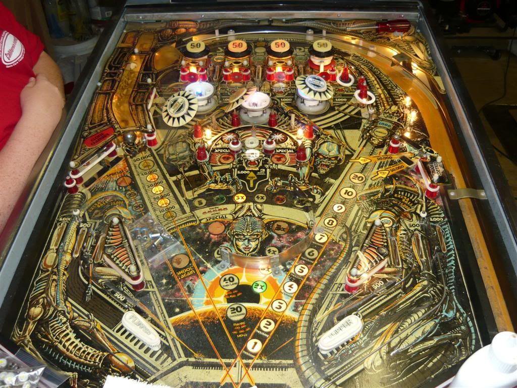

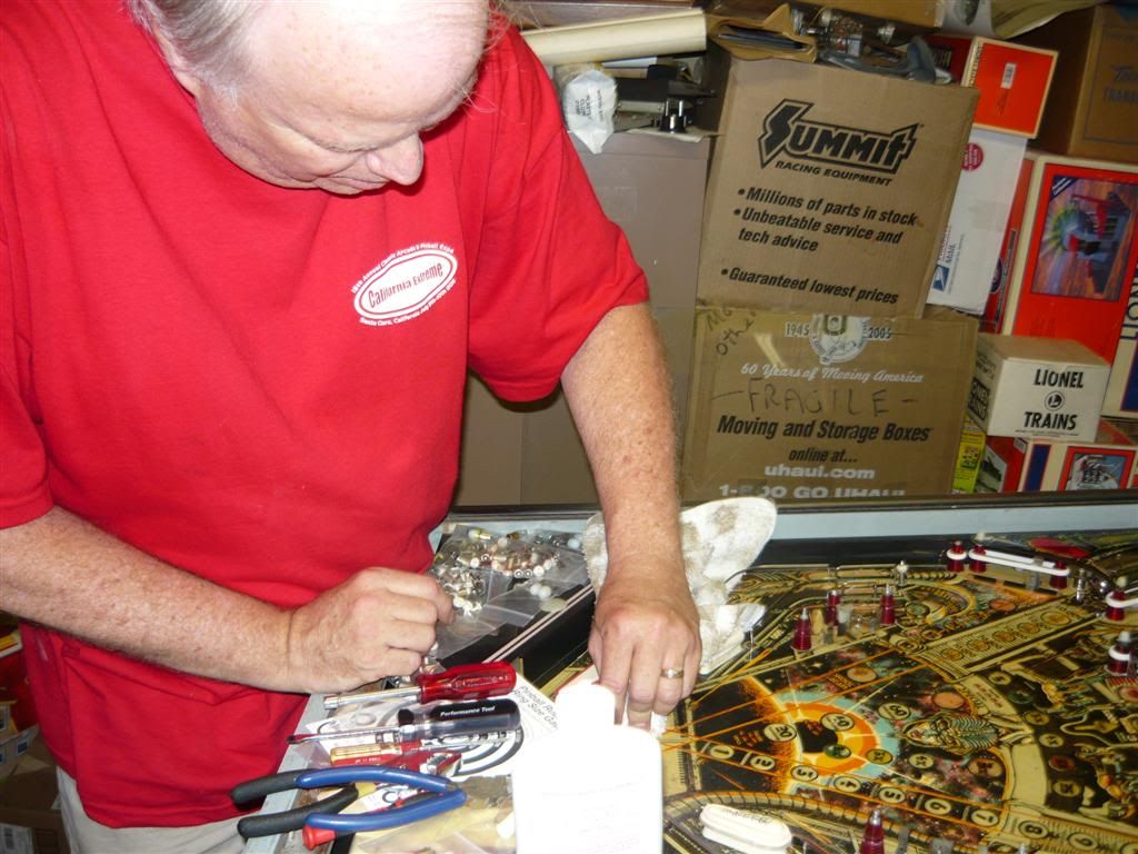

I've been working on my pin, trying to get it to a point I can move it into the game room for some play. I spent last Monday (took the day off after CAX) working on the play field.
I cleaned the entire playfield with Novis 2 then waxed it. I replaced all of the GI bulbs with LED's and installed new rubbers and new repro playfield plastics. I think it came out really nice!
The only thing left is for me to replace the connectors to the Aux Light Board since my backboard lighting is glitchy due to the connectors.
Here are some pics from last Monday.
Tom
My son Sean and I going over the rubber placement chart:
Cleaning the playfield
Cleaned to about 1/2 way down. You can see the difference in the colors and blacks:
Half of the rubbers and plastics installed:

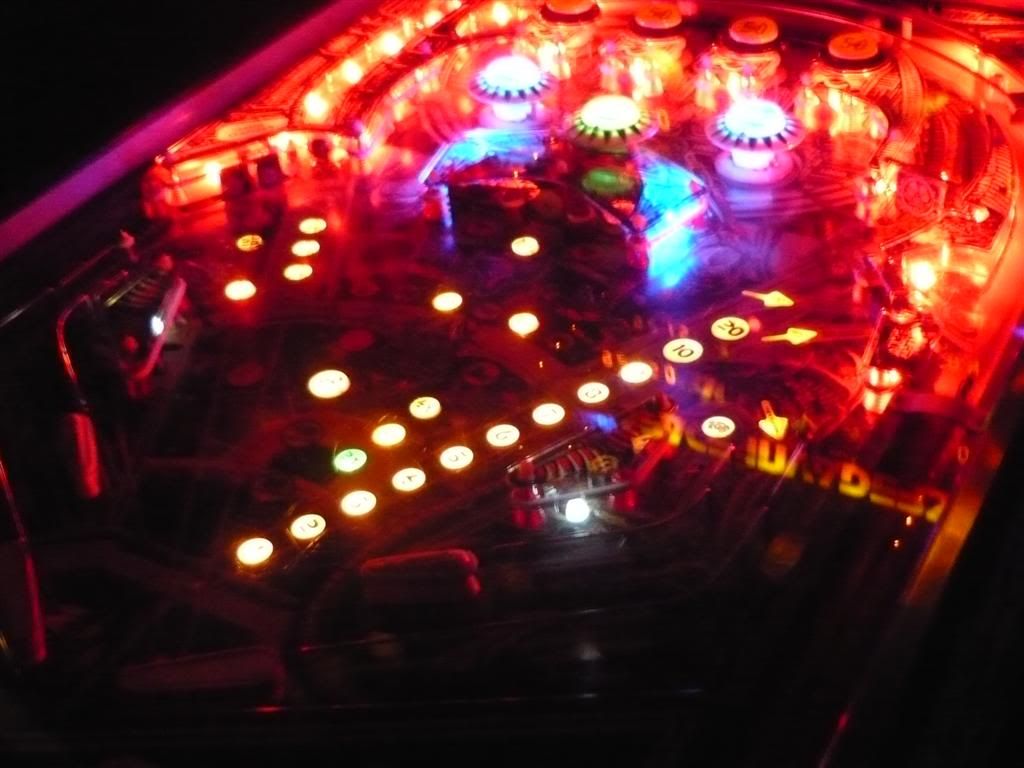

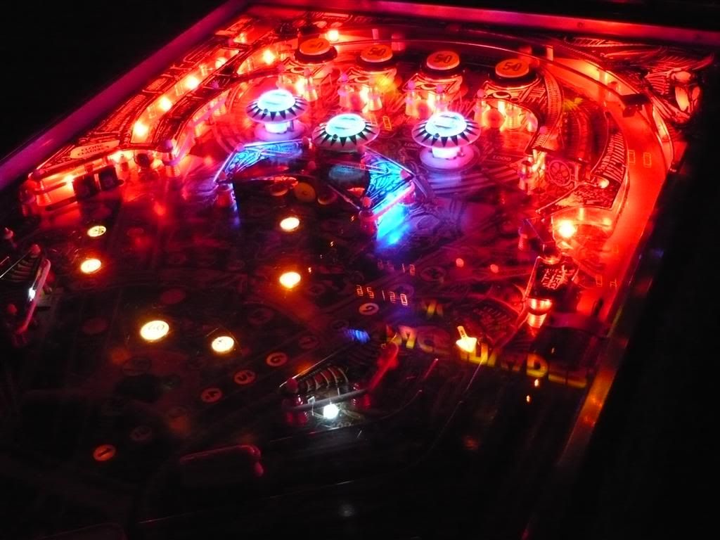

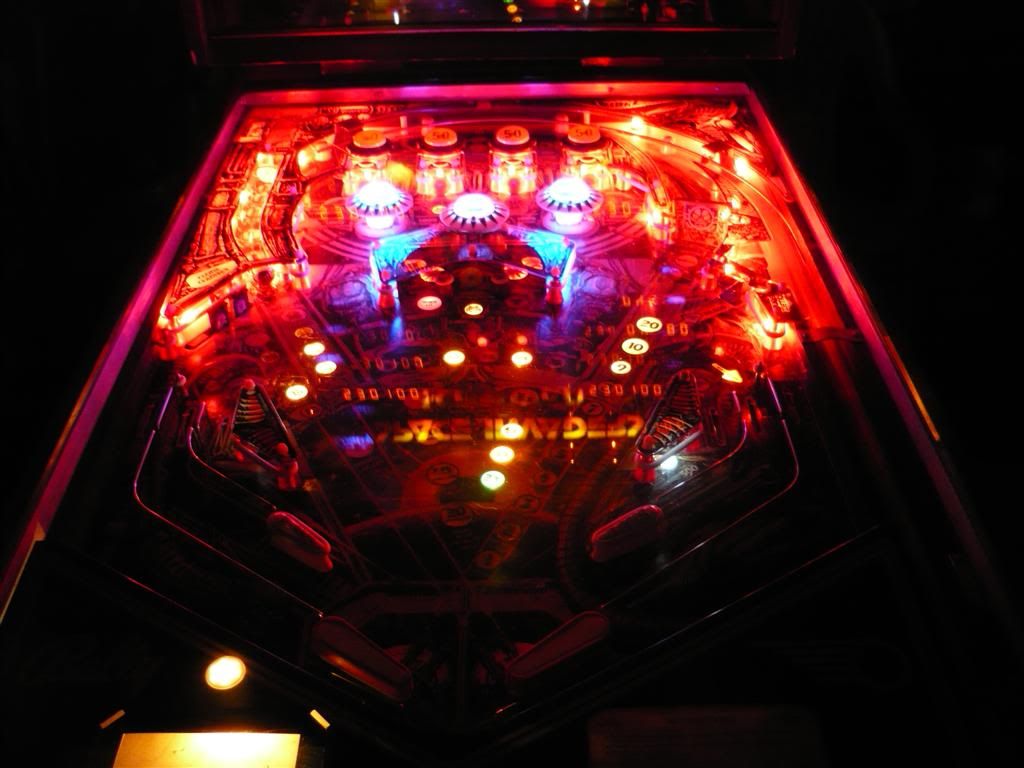

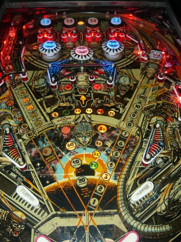

Here are some more pics after it was put all together with LEDS:
The controlled lamps are still #47 bulbs, the center pop bumper is a color changing fading LED. Most of the upper playfield is red LED's as you can see. The clone chamber outer lights are blue LEDs. Looks awesome in the dark, at least we think so.

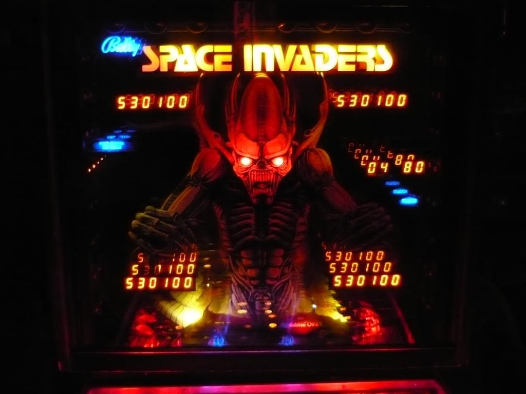

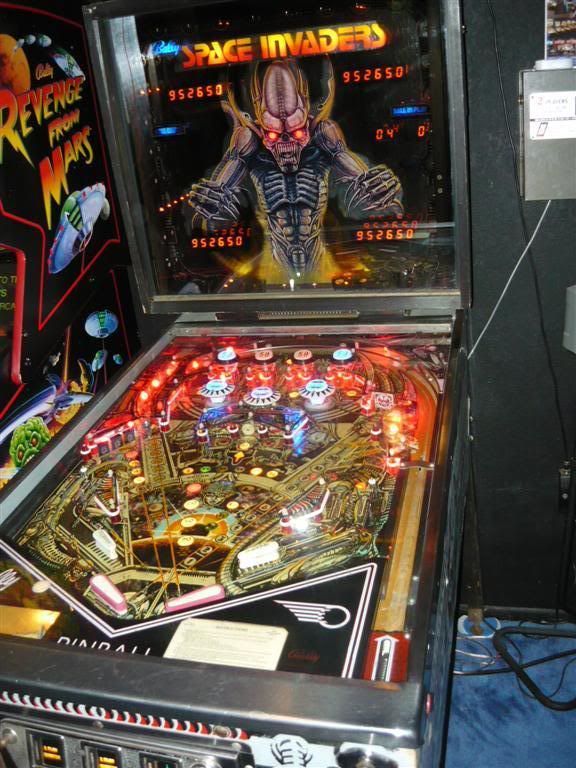

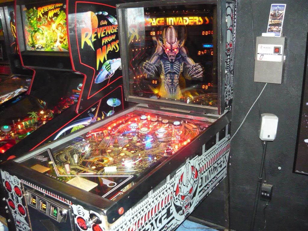

Here's some pictures of it in the game room now.
