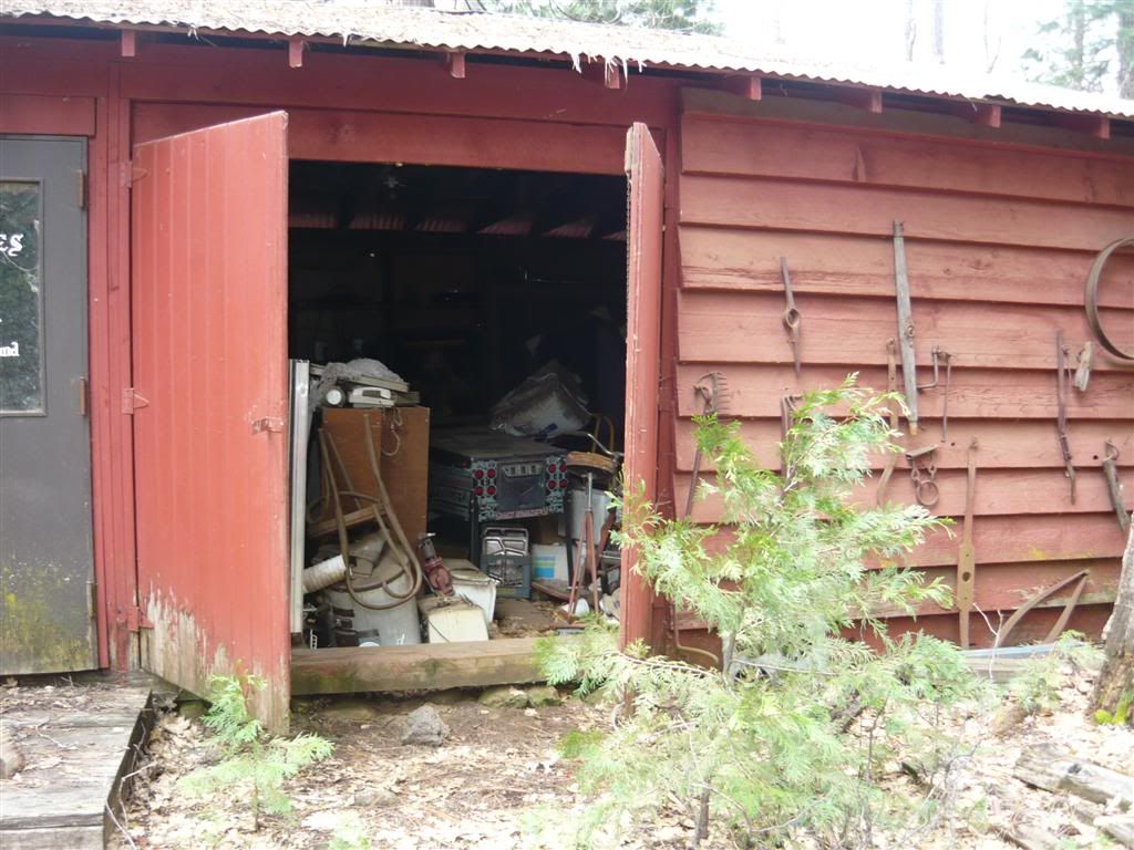

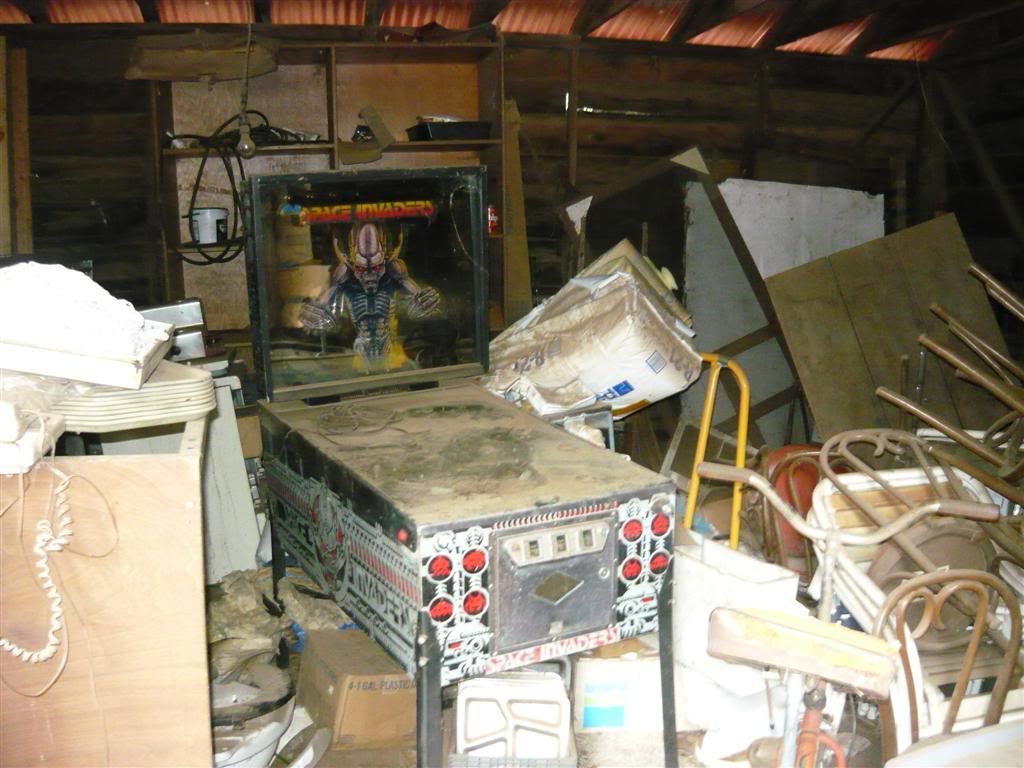

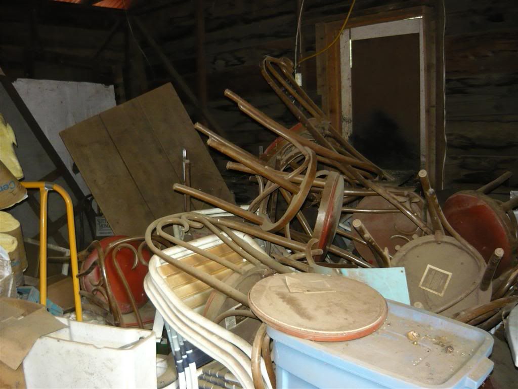

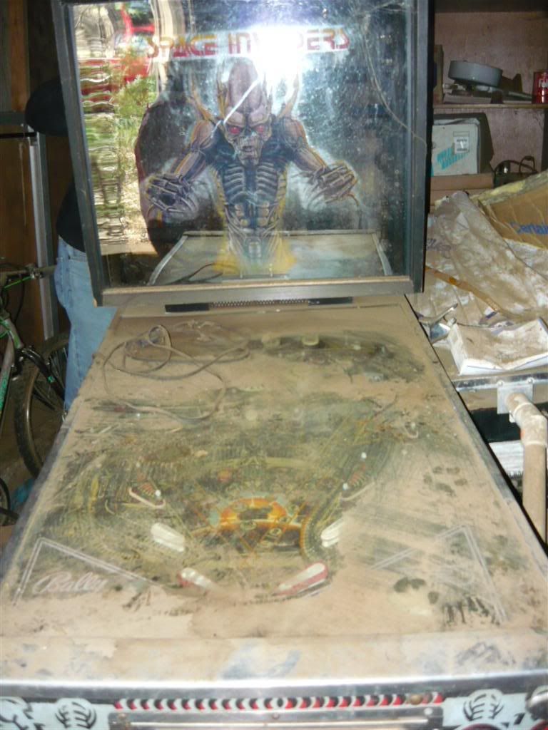

Here are some of the pictures I took when I picked it up. I literally pulled it out of shed. When I got it home and opened it up I was surprised to not find any dead rodents or nests in it. I found a collection card inside it listing how much was collected and when. The last collection was in 1994. Filthy dirty but the playfield is not too bad.
Enjoy,
Tom

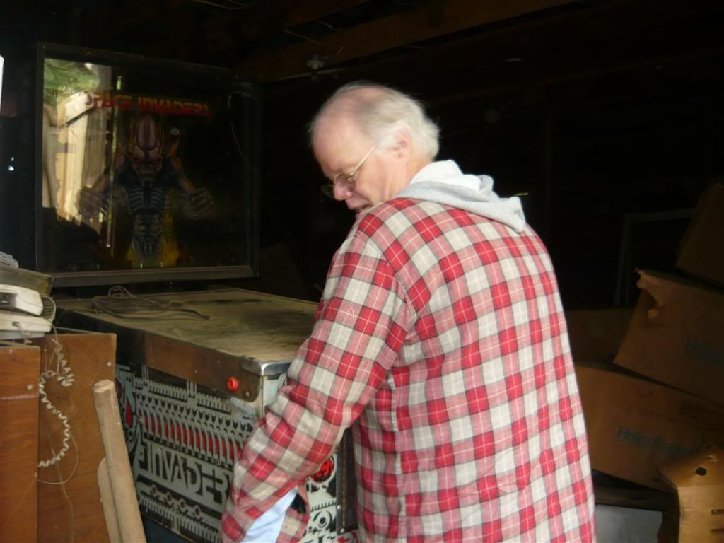

Oh, and I had help pulling it out. My helper was handling the other end so you can't see him.
Tom
In the shed, alot of this junk was piled on top of the game so it all had to be moved aside so it could be extracted...

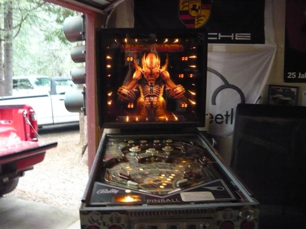

Here are a few more later after I got it home.

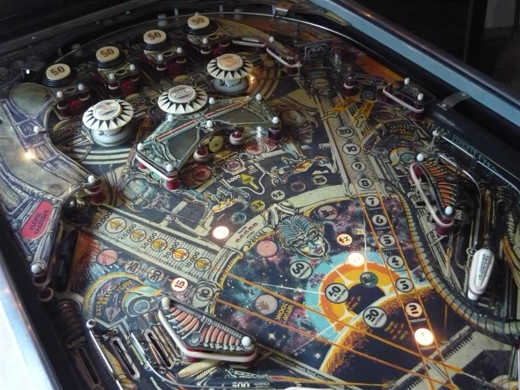

With the glass removed, here's the playfield. It's not too bad. Some wear on some inserts but not too much on the field itself. It is WAY dirty and will require a complete cleaning.

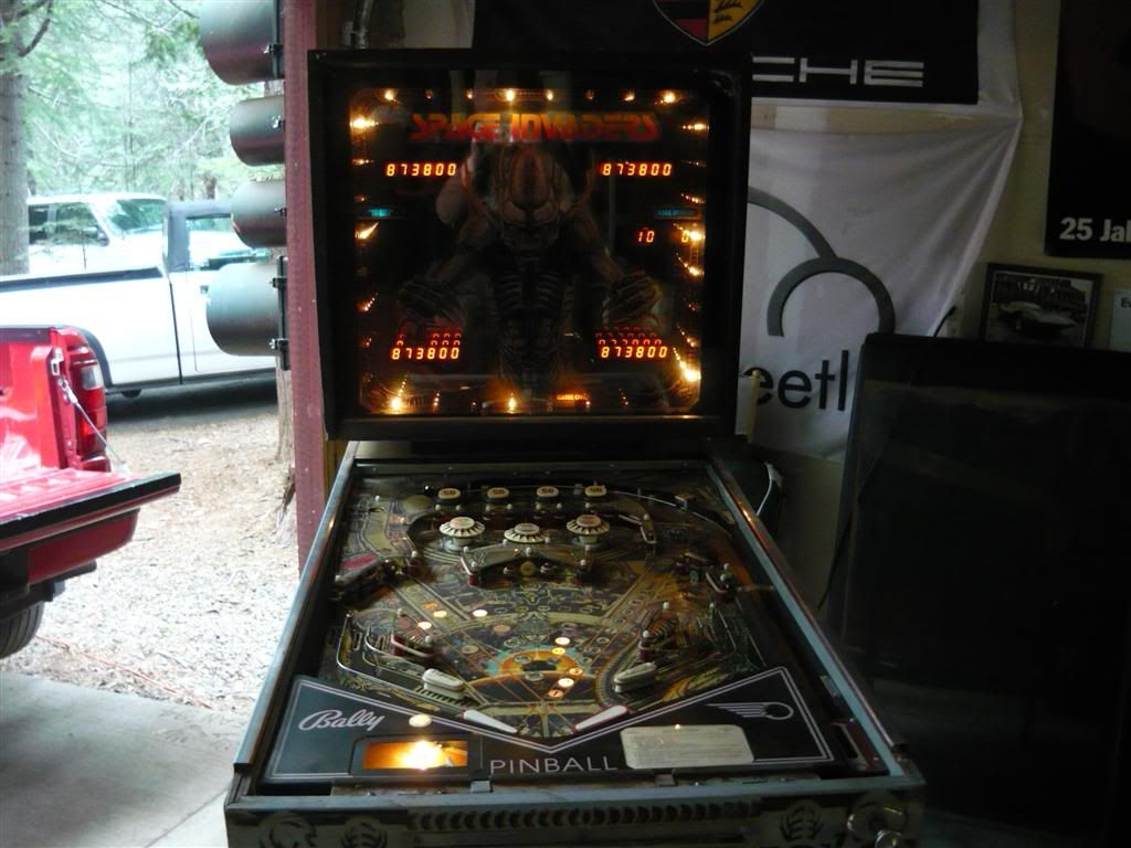

My friend Steve who helped me carry it out couldn't stand not knowing if it would power up. So I looked at all of the connections in the back box. There were not any burnt ones so we powered it up. In retrospect, it was not a good idea because at the time I did not know about all of the burnt connectors on the power supply and incorrect rated fuses in there. Could've burnt it up in my garage - but it didn't.
That's it. I'm working on rebuilding the power supply at the moment. The CPU has a minimal amount of acid damage that will have to be dealt with before I know what else might be wrong. I've never restored a pin before, but I'm looking forward to working on this one. There's just something about it I really like.

Tom,
Nice score! Congrats on the find. Looks like it is in pretty good shape other than being a little dirty. Good luck on getting it back in tip top shape. Keep us updated on your progress.
wow, that is in much better shape than what I'd have thought considering where it came from. I love those barn pictures... I have now taken to bringing my camera with me whenever I get a new machine so I can document where it came from like that.

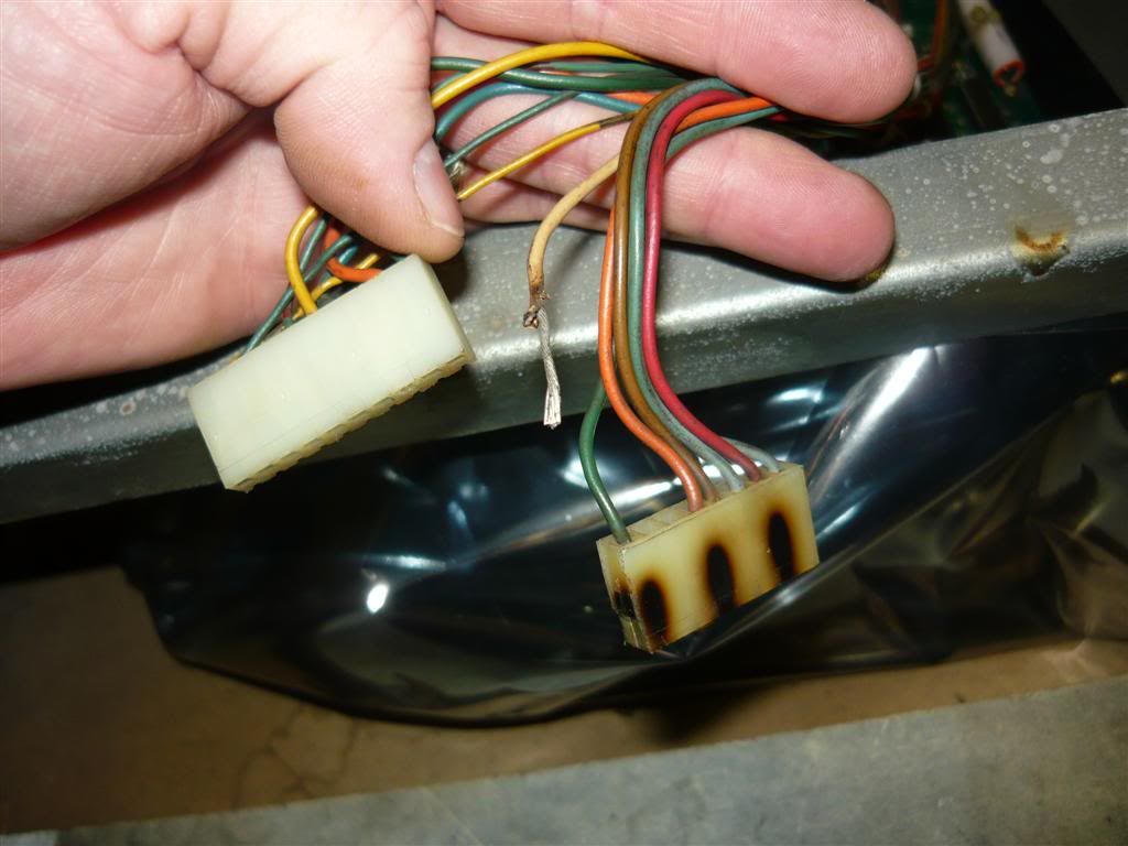

Thx guys for the positive comments on my barn find. Here's a couple pics of the power supply connectors I kind of mentioned earlier...
Here's the main connector, broken in two, burnt connectors and a wire that was soldered directly to a power test point on the supply.
This connector had it's end pin sliced off and had that wire directly soldered to it's intended pin.

OK, I cheated and picked up a Alltek MPU and solenoid control board. I installed them last night and gave it the smoke test and the game came alive!! It was kind of a good news / bad news thing. The game is now playable but there is no sound. Testing the sound board came up with nothing.
So we played it for a couple hours. Everything else seemed to be working fine, there were of course lots of bulbs out and one limp wristed flipper that needs looked at, but I was quite happy. Then the upper playfield lights went out, but the game was still playing.
Looking at the fuses, I see that F5 blew. I don't have it with me at the moment, but I think it was a 10amp fuse. Looking back at the manual, it looks like that fuse should have been a 20 amp. I hope that's all it was. I'll pick up some tonight and give it a test again.
I've posted on RGP for a tested and working sound board...I'll see if anyone replies, I'll post an ad for one here too. The game is still very dirty and needs to be taken apart and cleaned and re-rubbered. I'm also going to replace the light bulbs, some with LEDS, some with the lower voltage 47 bulbs ( I believe that's the lower voltage ones...? Some correct me if I'm wrong). I have new replacement play field plastics and such. The originals are really bad looking, dirty, and warped. Looking forward to seeing this cleaned up and back together again.
I'll snap some pics of it working tonight if the fuse does not blow again!
