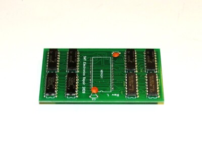

So I read somewhere about an updated ROM set not need the the "bit shifters" so could it be I have the latest ROM so they took the chip off, but the other games in the multi kit were not programed to work without it.
I did a bunch of images searches and found pictures of the board both populated and unpopulated IC3. Some didn't even have the socket installed (but the solder footprint was there) with working game boards.
Does any of this sound legit?
So if I end needing one of these any good place to get one? The one on ebay won't fit on the 3-board stack as it would hang out past where it would sit in the card rack.
Highly doubtful.
It'd be way too slow to perform the bit shift operations in software on an 8080.
Highly doubtful.
I just read a link (trying to find again) that said most 3 board stack space invaders set will run fine without the MB14241 chip if using CV rom set.
Here's the link I found thats says 3 board with CV ROM set usually works without the chip:
Which makes sense, since mine worked fine before the multi-kit(and even with the kit for space invaders i). I never had that chip in the machine since I've owned it.
Did you say you made a repo? small enough to fit on the board and still fit in th board cage?
Actually the ebay one might work looks like the sound board doesn't go on the rails it just hangs out the cage. Although a smaller would better if there other options.
I said that there where multiple designs for the sound board shifter. I f it was designed not to use a mb14241 it would incorporate the 8 151 chips. after you took a look at the chip labels it confirmed which schematic you need and the board design. the built those boards for what they had available and what was going to be cheapest for them to use. without a shifter you are going to have some problems
