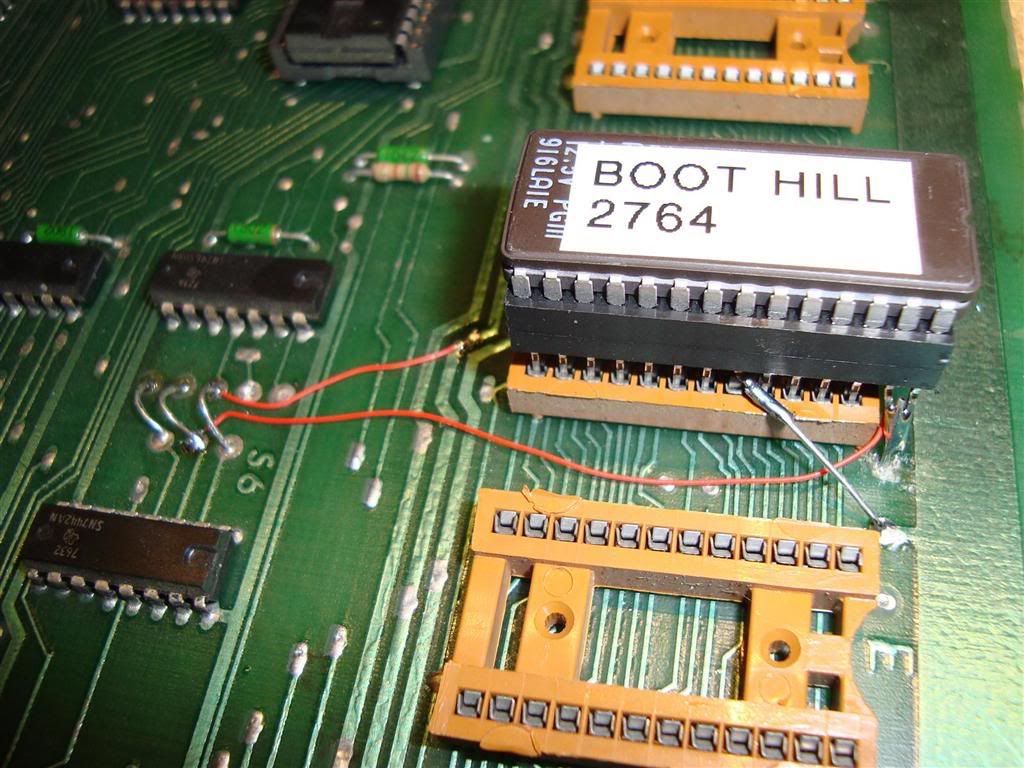

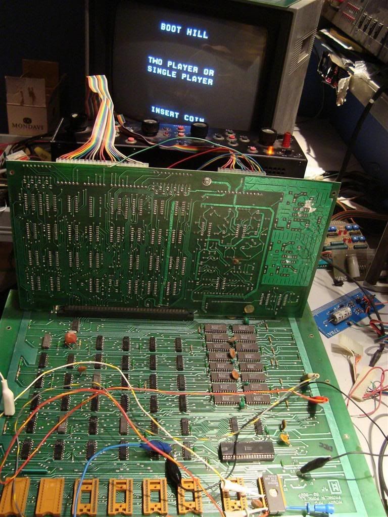

here is a Boot Hill on a single 2764:
copy /b ROM.1+ROM.2+ROM.3+ROM.4 single.rom
Ya know, I'm a DOS veteran (IT person here) and I was going to ask about that but just never did. I'm used to asking about stuff like that and having people sit there and scratch their heads. I guess that explains why I'm always on here.
Sweet that really helps guys, also that pic showing the S6 jumper really helped too, as apparently midway didn't label that particular jumper! Its there though.
