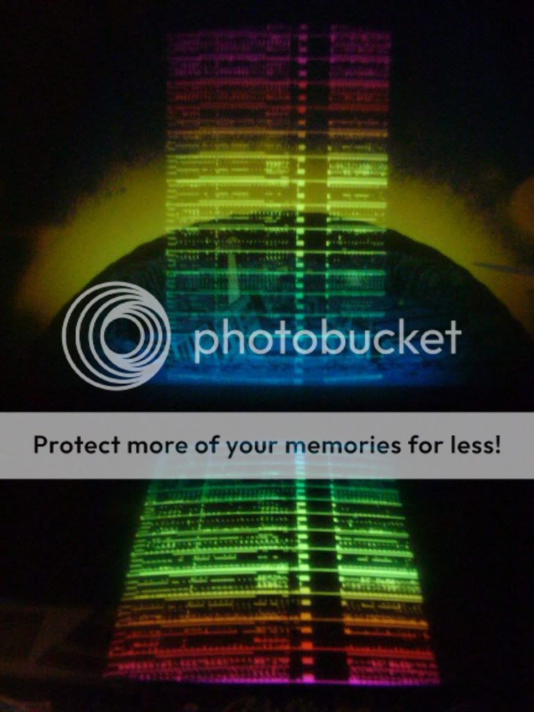

So I need some extra advice..
Space invader Deluxe-
Monitor is fine
All lights are fine
Hearing sound fx and has a garbled screen.
I know about re-seating chips, cleaning edge connectors, voltage ect..
Anything else I can do?
Got a feeling, this baby is close to playable..
Dan
I just picked up a Midway Space Invaders a few months ago with a similar problem.Best bet is to get a ram test chip.I got it, replace the one bad ram chip, and got it working. Now I have to fix two missing sounds,but it plays fine.
