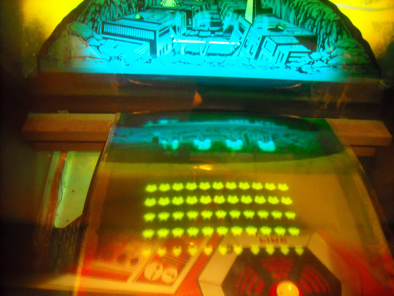

Anyone with any experience with the black and white monitor in a SID?
My monitor is pretty dim and in need of a cap kit and the flyback is whining.
Any suggestions on working on this one (anything going to blow if i discharge it as I've read with some black and white monitors)?

The picture is stable with a little bleeding like a monitor in need of a few new caps, almost looks slightly out of focus. See the picture at the beginning of the thread. A few of the caps look like they have leaked a bit and are bulging at the top, so those are going to need swapped.
Brightness adjustment pot works, but doesn't improve the issue, just turns the screen a dull white. Contrast pot seems a little out of wack, so that's getting cleaned. I don't see anything for brightness near or on the flyback. I'll get the model # in a few mins.
No whining coming from the light fixture, it's coming from right around the flyback. Hard to pinpoint with it in the cab still, but not the light (removed all power from it and the whine remains, can hear it from right inside the coin door to the left) The starter and bulb were also replaced (using a white black light)
The front of the tube has been cleaned, along with the overlay and the mirror, so no dirt there.
Model - WG V1001
After cleaning the contrast pot the focus issue is resolved, just needs to be just a little bit brighter.

The whining is not coming from the flyback but what sort of resembles an isolation transformer...which is slightly off to the left of this pic.
