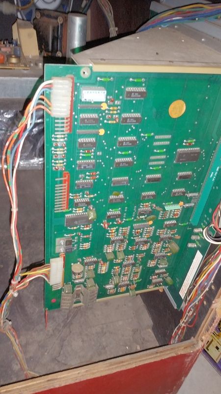

Ok Guys tackling my Space invaders Deluxe Upright.
I Purchased a used PCB.
and i usually take pics before i dismantle stuff..LOL and of course now , i cant find the pics of Deluxe space invaders wire connections.
Can someone tell me the wires Pin out for voltages .
Thank you
Also Can someone tell me if this correct.. Do the PCB have a light that turn on ????
Dont see anything. Maybe i missed it somewhere.?
I powered it on and the only thing that turn on was the Monitor..

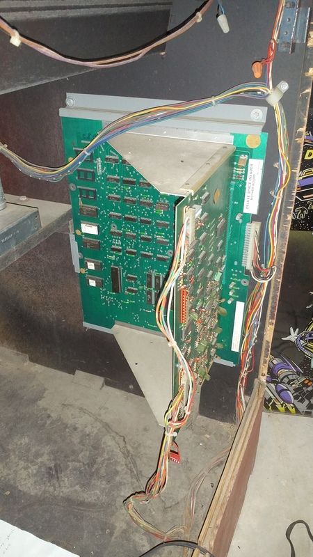

Ok,Found this ...
on the daughter board of my PCB
top has has 12 pins the next has 11 pins and the bottom has 15 pins ...??????
Another Question This audio Bd.Does it also act like a power switch supply too ??????
The pinout on the chart is for a upright Midway Space Invaders. Your Space Invaders Deluxe looks a little different but the pins are the same. What the chart called the 8 pin connector would be the top 13 pin connector on yours (remember to count the key). The middle 12 pin is not used. The bottom 16 pin connector is the 11/14 on the chart.

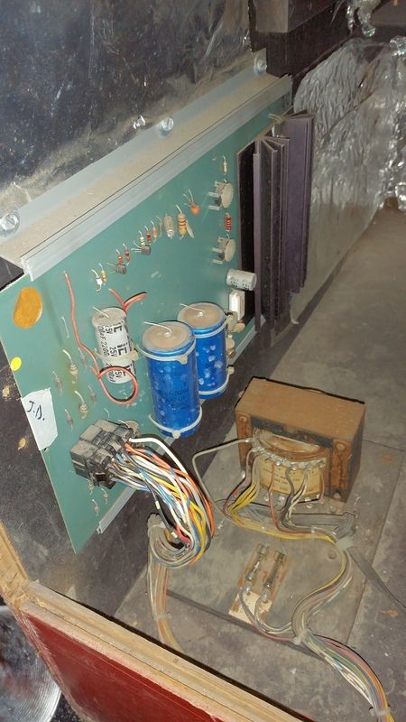

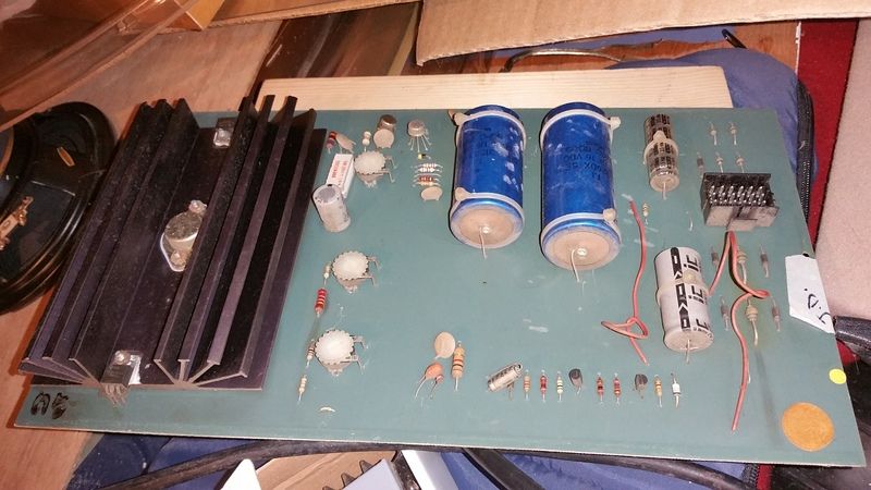

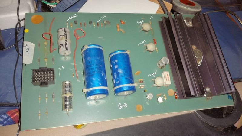

Ok tested the linear bd the +5 was testing +4 . So i turn the pot all the way to the right and i'm getting +4 to +5 keeps jumping.. Game turn on but the sound was low . I turn the
volume pot on daughter bd all the way up and still sound is low.
Also notice that the left button to turn ship to left is not working....

I had one of these in my original space invaders, thinking of putting one in my deluxe. Works great actually.
Rebuilding the original is a piece of cake thou... To be honest
