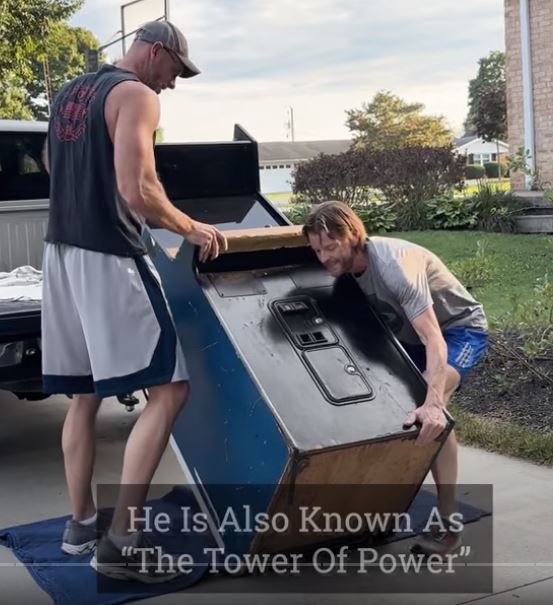

Talking about knowledge - how tall is the Tower of Power. Wowzers. LOL
6'10". He was a starting center at a Division 1 school (Eastern Illinois) for 4 years. My childhood dream was to play college basketball but I stopped growing at 6', so I had to live vicariously through him instead. We grew up together in this neighborhood and both moved back into it. He was a dunking machine—bent the rim at my parents' house dunking in 7th grade…
He's often my go-to when I need a hand :)
