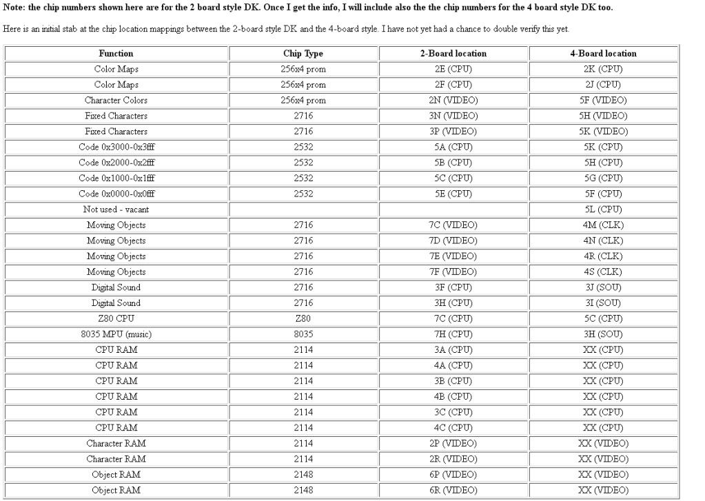

Found some good info today on Brasington's site. A chart listing all of the chip mappings for the Kong 2 and 4 board sets. Though I'm sure things will be a bit different on my Space Firebird board sets, this should prove useful in narrowing down what chips do what on my boards:
OK, bumping this back up again. Thanks to darthi8nt, TWO space firebird board sets have been repaired. So, now the intention is to convert one of them into a Space Demon with ROM swaps. Here's a good info page I found on each game:
Space Firebird
Space Demon
According to each of those sheets, the boards are identical in their builds. Theoretically, it should be possible to swap out 8 eproms on the CPU board (all 2716's), 1 eprom (2708 chip), 2 eproms on the video board (2716's) and one prom chip at 3N on the video board (32 bit prom).
These 2 boards are currently being benched by darthi8nt, and he's successfully burned all the eproms (10 2716's total) but we're having trouble with the 2708 eprom from the sound board, and the 32 bit prom from the video board. We had steph from hobbyroms burn us a prom for 3N, but the board won't boot with all the SDM roms inserted with that prom. I suspect that either the 32 bit prom or the 2708 eprom (chip 20 from the sound board) is not correct. Unfortunately, neither darthi8nt nor myself have the capability to read *or* program to these types of chips. Does anyone else here have the ability to work with these older types of chips that would be willing to lend us a hand?
