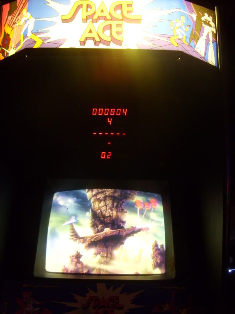

Picked up the non working Space Ace with a working Dragons Lair Last week. Got her going tonight. Im pretty good at Dragons Lair, I suck at Space Ace.
Awesome Dan! I type this from fishing up by the Alaskan Pan Handle, thx for sending me the link!
What was wrong with it???
Well the guy said it started resetting back in the late 80's. He said the sound was super loud, and he disconnected the speakers. He said it died a few years later, prob early 90's.
First thing I noticed was a wire came off the interlock switch, reconnected it fired up. I hooked up the speakers pots were shot, there was another speaker pot assembly in the parts box that came with it. hooked it up sound was perfect. The machine was not resetting. The dip switch for service was on, it basically made it to where you always had 5 lives, and the game continues forever. Set the dips on the right settings. Machine is 100% now:cool:
