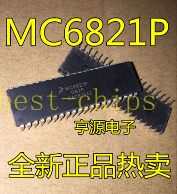

OK, a month later (thanks Canada Post) I received my TEN samples of cheapo $1.12 6821.
Testing in the Neoloch Inquisitor, I found than 9/10 PASS and 1/10 FAIL.
The FAILED unit passed all tests with the exception of E24/E25/E26 which relates to the CB2 Strobe function.
So, what can we conclude?
Well, maybe I just got lucky. :)
All the ICs had the same top MOTOROLA markings/text which is suspicious. The 40pin package had slight differences (pin 1 marking/hole/notch etc) on most of them. One of them had text on the underside noting it was really a 68C21.
If anyone else wants to roll the dice for some cheap MC6821P, here's the Ebay seller's info:
2pcs MC6821P MC6821 Peripheral Interface Adapters DIP-40 #K1995
I think more than suspicious :D
I ended up getting money back from UTsource on the 6809Es as they were clearly remarked. Impossible date codes. Identical labeling/date/lot markings but at least 3 different ejection molding/packaging types.
