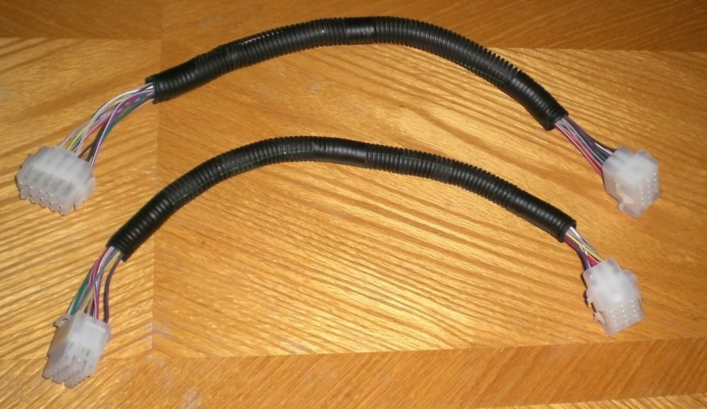

Also, on the Star Wars extension cable...what was going on there? Were they just trying to get more cable slack to hook up a Wells Gardner 6100? If so, I make those extension cables for that:
No idea. There was a 6100 installed in the cabinet, and the wiring harness leading to it was extended by cutting the wires and adding in (all red) wire with those cruddy crimp connectors.
Yeah, I mean, anyone can make extension cables, apparently the OP that fixed it back in the day didn't want to, or didn't have the connectors on hand, or something. Lots of bad repairs were made to keep these games in service. Really, there's no real problem with cutting and extending the wires, he just did it in the most ass way possible. I fixed it up with proper solder joints and shrink tubing, and gee, now I don't intermittently lose colors! Imagine that.
As for the original topic of the yoke connectors, I haven't actually run into a situation yet where I'd have to buy any - I always just desolder and save the harnesses from the TV/junk yokes I don't use, and if I need to change the connector on a yoke, I just replace the harness. That way there's no cutting and splicing :)
-Ian
