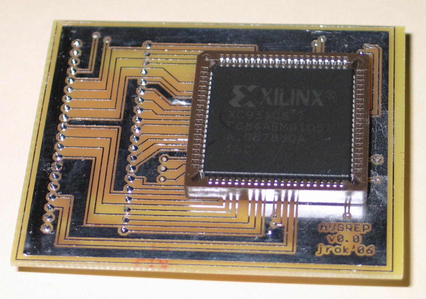

Jrok was going to do one, I just don't know that he ever did. He has this on his site.
Next up is the Atari AVG in a Xilinx XC95108, this is a freeware project that I'll put all the details and source/schematics. Expect that soon.... ish..
Edit: I was set straight on the boards below.
Arcadeshop's is Omar's.
And this one is Clay's.
Edit Again: Here is a prototype of Mark's
I got mine from Arcadeshop a few months ago. Warning that there's doesn't work on Space Duel. I waited an extra month for a Space Duel fix and it still didn't work. I ended up putting it in my Star Wars and using it's AVG for my Space Duel.
The Xilinx one is Omar's, not Jrok's....
2nd one is Clay's.
3rd picture was one the prototype from the ones i built...
2nd one is Clay's.

Thanks for clarifying. I will go back and edit my post. It looked like it might have been Jrok's work.
It looked similar ;) I used the same socketed PLCC as Omar's. I never made more than 2 which I'm using on my boards, as this was right when Omar did his run of board.
- James
Cool! I should have know Omar's was not yours though even though they do look very similar... I really like how you use the negative space when you layout the board. :) I presume that makes it easier to etch since your removing less?
