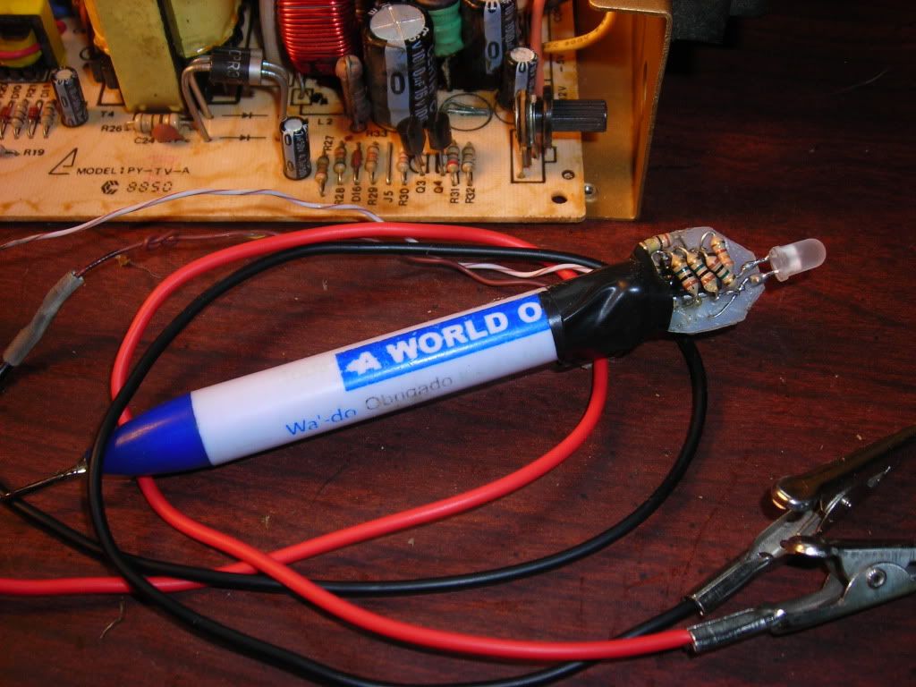

if you have a probe that generates the sound from the signals coming in you can use this method..
If you have a probe that is triggers a sound circuit from the signals coming in the tones sound the same..
Nothing like taking a pobe apart and say hey this one is a crappy designed one.
Fixed, bad PROM at 1D. Pulled one off of my non-working Galaga boards, and put it in, no more desire to strangle puppies.
A home brew one doesn't look as nice as a commerical one at least youy know how it is designed is and you can customize or fix it when it does break down.
I picked up a cheap little RadioShack logic probe from eBay. ... Not surprisingly, Radio Shack doesn't sell them anymore. I guess they were deemed "too useful". Anywho, paid about $5 for it or so and while I can't "hear" the sounds generated by the game through the probe, the pulses to change with respect to the frequency of the sounds... if that makes any sense. It only works with basic stuff like I was try'ng (unsuccessfully) to trace out some missing audio on my Crazy Kong boards. I can get a rough estimate of what's going on by listening to the change in the buzz/beep from the probe. It's only really useful on older machines... anything that uses fancier audio though, and the probe might as well be a wiener flavored lollipop.
