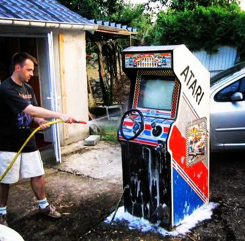

Just show the cab who's boss.
DIOkI_kW4AAlkVK.jpg:large

Thanks for all the replies and that great pic showing how to thoroughly clean a machine.
