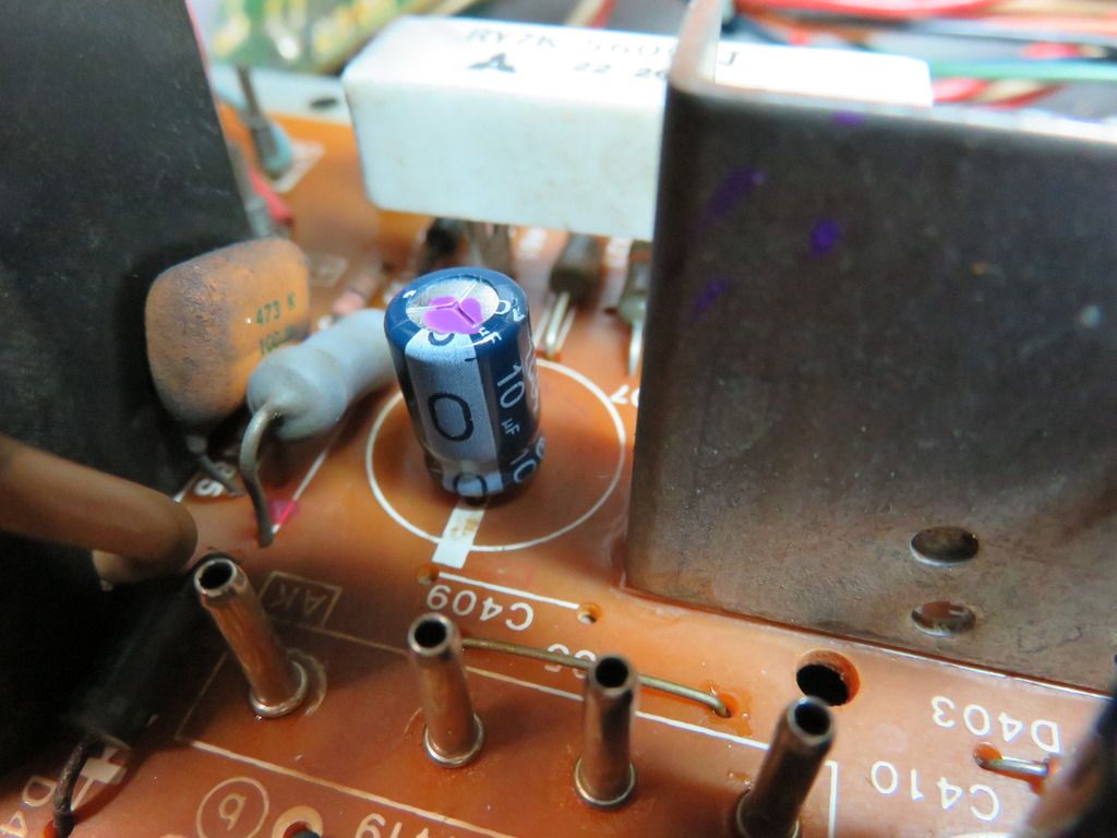

C407 Huge old 10uf160v cap. Replaced with this tiny little 10uf160v. I've tried looking for correct cap lists and cap maps for the Atari 14"/Sanyo EZZ-C but what I've come across isn't entirely accurate.
Pretty much just replacing caps I find with like.
Holy crap!

To be quite honest,
The only one that concerns me is this. So small for the original displacement. Kind of still makes me wonder if this is the appropriate cap for C407 of the EZZ-C. A 10uf160v.
I was pretty sure when I bought this that it was for the Atari version of the Sanyo, however the cap map was for the 20EZ. And I will say that this EZZ-C doesn't have alot of similarities to the 20EZ. I dipped heavily into my stock of caps to complete it.

it is rated the same but its case size being that small is a good indication that its a very low hour crap cap.(Plus the brand too) It will work but only for a short period of time. with 170 games of my own i barely have time to rebuild them once let alone every year or two so that is why i put the best quality caps in my kits plus the time to pull these out, clean, adjust and reinstall isn't worth skimping on caps to save a few dollars in my opinion.
