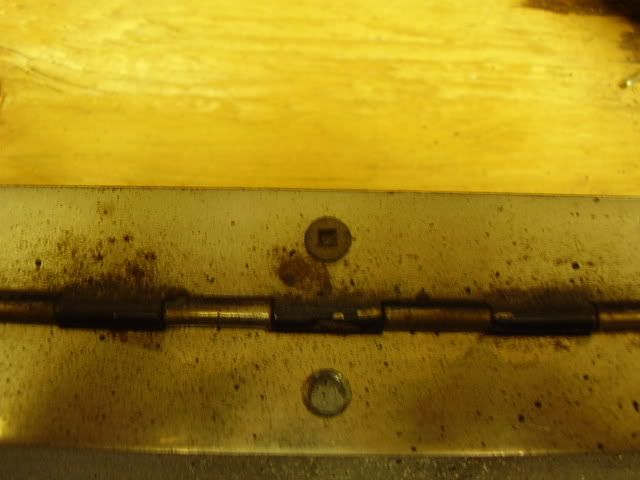

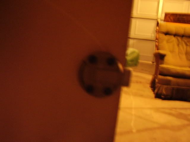

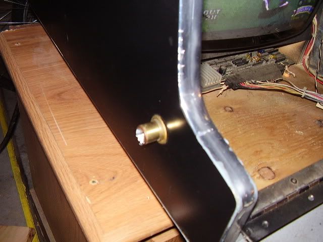

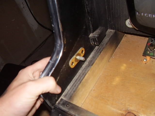

There are also some strange locks on it that I haven't seen before.
The locks for the control panel have a pin built in that inserts into the control panel
and holds it down when locked.
The lock on the back door is also different, but I think a standard lock could be made
to work in it's place.

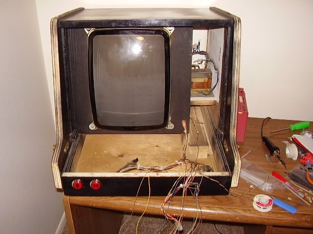

So far, I've wiped down the inside and removed enough of the grunge
that I can see what's going on inside the cabinet.
The jamma harness isn't as bad as I thought it was.
Some light soldering and heat shrink tubing should clean it up pretty well.
I've just got to add some wires to the harness for the 2nd and 3rd action
buttons as well as the test and service switches.

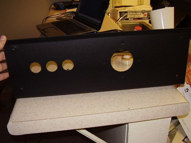

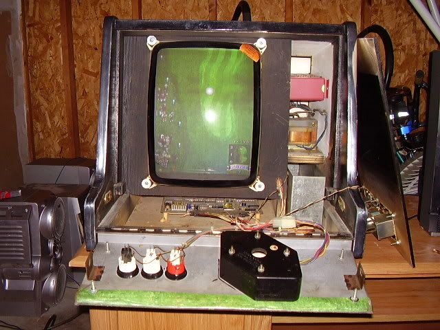

I got around to removing the old cp overlay.
It was much easier than the last one I removed.
I imagined spending hours trying to remove it with a scraper and goo gone,
but this one took about 3 or 4 minutes and left nothing behind.
I had some black cp overlay left over from my other project, so I just used that to cover
the control panel.
It turned out ok. there are a few rough spots near the track ball and the spot welds
for the cp latches, but it shouldn't look too bad under plexi.
Hopefully, the plexi will clean up well enough that I can reuse it.

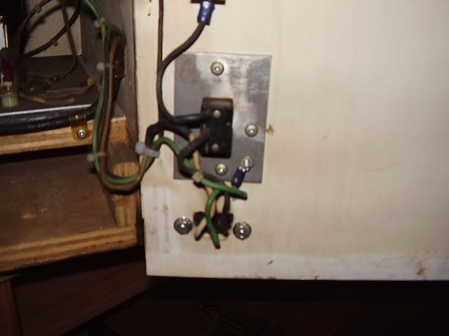

The power cord was pretty mangled and I didn't really have a spare,
so I cut a hole in the door and installed a socket that I kept from a
dead atx power supply.
Now I'm just trying to work out how to secure the game boards to the cabinet
without having to screw the pcb feet to the plywood each time I want to swap the game.
It should be a challenge considering the small space I have to do this.

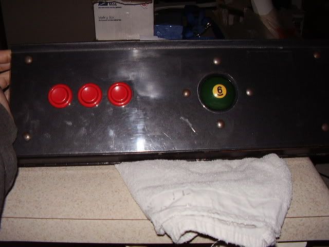

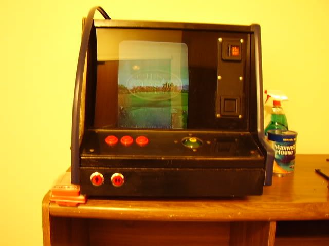

I got the control panel populated after Cleaning the trackball assembly.
I put the plexiglass in the dishwasher and it came out well enough that I decided
to reuse it. I also swapped the trackball with a billiard ball that I found a while
ago in my first cabinet. It's a perfect fit and doesn't effect the operation of the
trackball assembly in any negative way, so I left it in there.
I also drilled a couple of holes in the front of the cabinet for the start buttons
since I don't have a way of drilling into the control panel at the moment.
Then I attached the cp, added some wire to the jamma harness for the other
2 action buttons, attached an adjustable PCB holder to make it easier to swap
games out, and finished up the wiring.

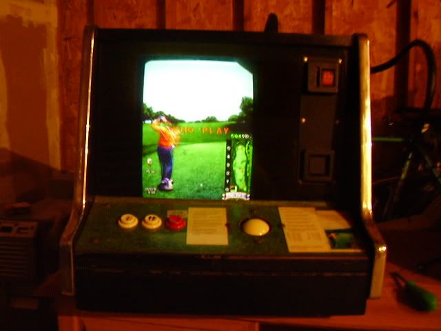

This is how it looks now.
The new t-molding is being glued into place because the slots are just a bit
larger than they need to be. I don't have an effective set of clamps for this,
so I'm just gluing one section at a time.
I've still got to wire up the lighting for the coin reject and the start buttons,
but that will wait untill the t-molding is finished.
There is a fair bit of gauss on the lower right section of the monitor that
I can't seem to correct with the degaussing wand, so I've still got some
work to do there.
Other than that and the moderate burn in, the monitor's in good shape
and has a decent picture. The tinted plexi over the monitor makes the
picture look dingy, even after a good cleaning, so I may replace it with clear
sometime in the future.
I tried to plug in my coors light bowling board, but it seems to have died
since the last time I tested it about a year and a half ago.
If I get a capcom bowling board, I can just swap out the roms and have
a working game again.
I spent a bit of time with the u.s. classics game and it turned out to
be a lot more entertaining than I thought it would be, especially since
I know roughly dick about golf.
The only real problem I have with it is that this cabinet wasn't designed
with these types of games in mind. It's certainly playable, but it's just about
impossible to get a good spin on the trackball without smashing my fingers
into the monitor glass. my hands get pretty sore after a good 18 hole game.
