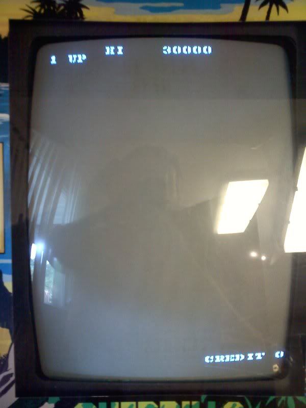

I have a Guerilla War Arcade with an extra set of PCB's. I Only need one so I was going to sell the other. But now my machine won't boot. Just my luck.. It starts up runs its tests and says all passed, but then it just shows
I have not turned it on in about a month, but it was working fine the last time it was on and was played for hours....
I cleaned everything up and still no go. Tried the PCB set I was going to sell and it works fine in my machine... What happened? and Does anyone have any Ideas where I begin to look?
Spare boardset working fine does not rule out the possibility of it being a power problem.
I'd verify the power, make sure there are no loose connections, make sure the chips are seated properly, and finally I'd check for burned connections on the board.
No need to be sorry.. This is just my luck, thank god I checked before I sold my spare set. I hope I can get it fixed, I could use the extra cash more than the extra board set...
Dip switch settings was set to self test.. My son is gonna get a foot in his arse, I bet he was trying to change settings on his own.. Thank You Oryk Zinyo, sk8ersublime.. Sorry I wasted your time and posted this wasted post... How can I delete it?
