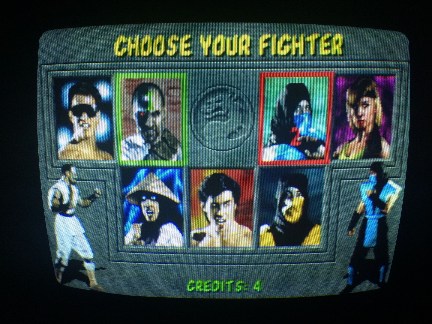

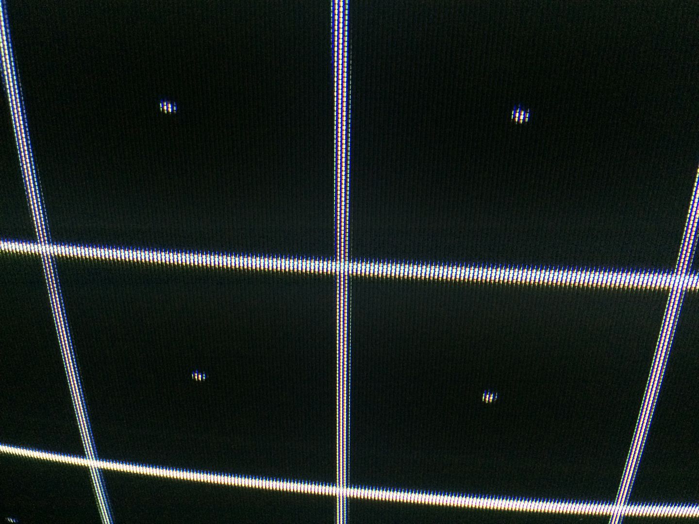

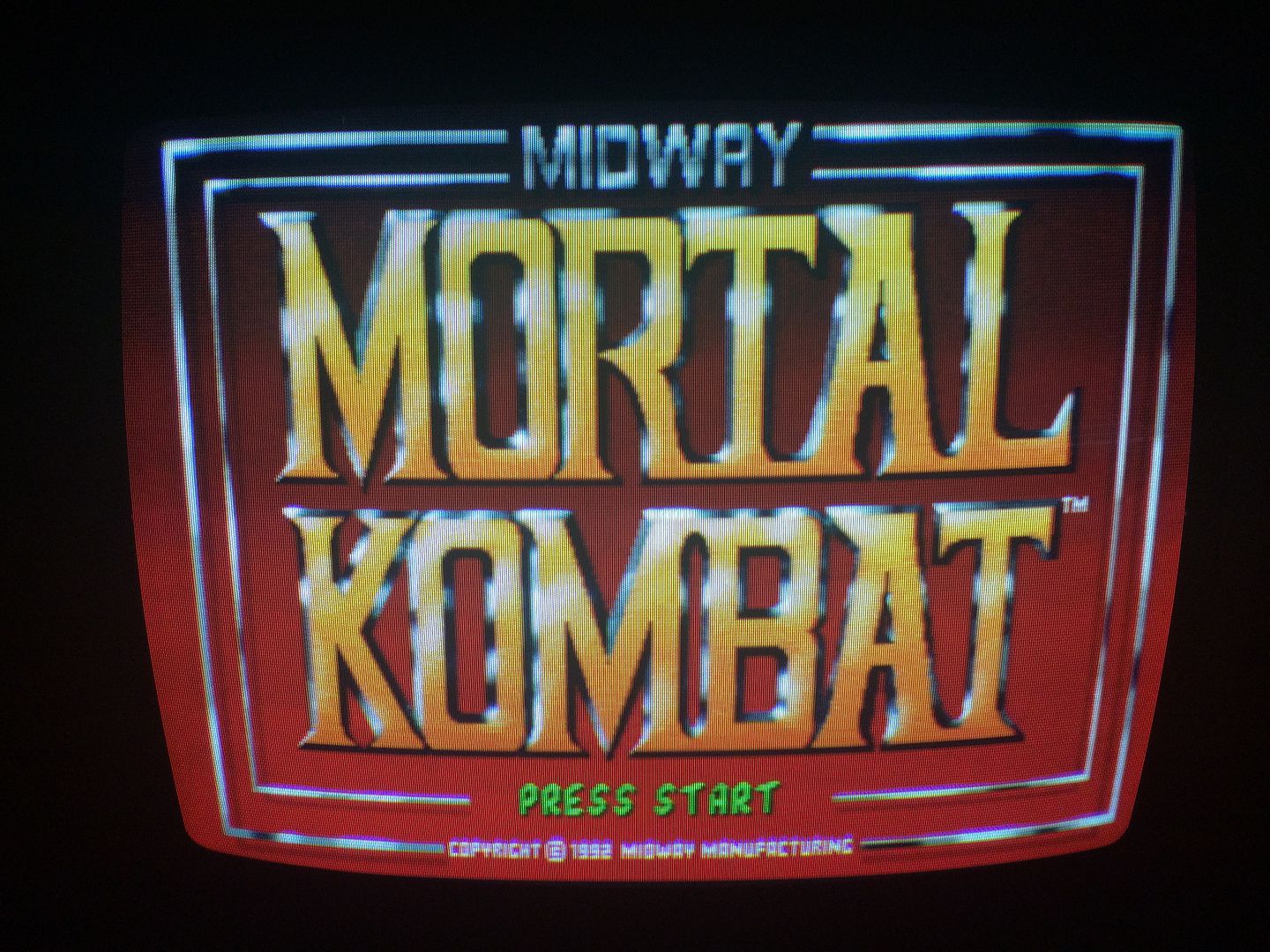

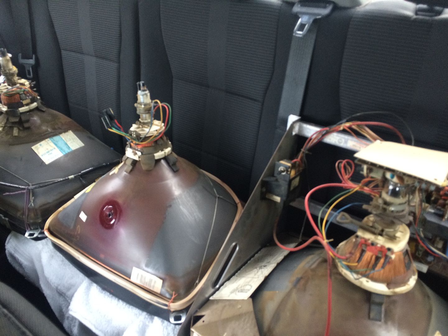

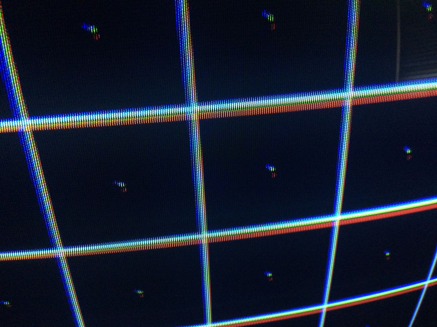

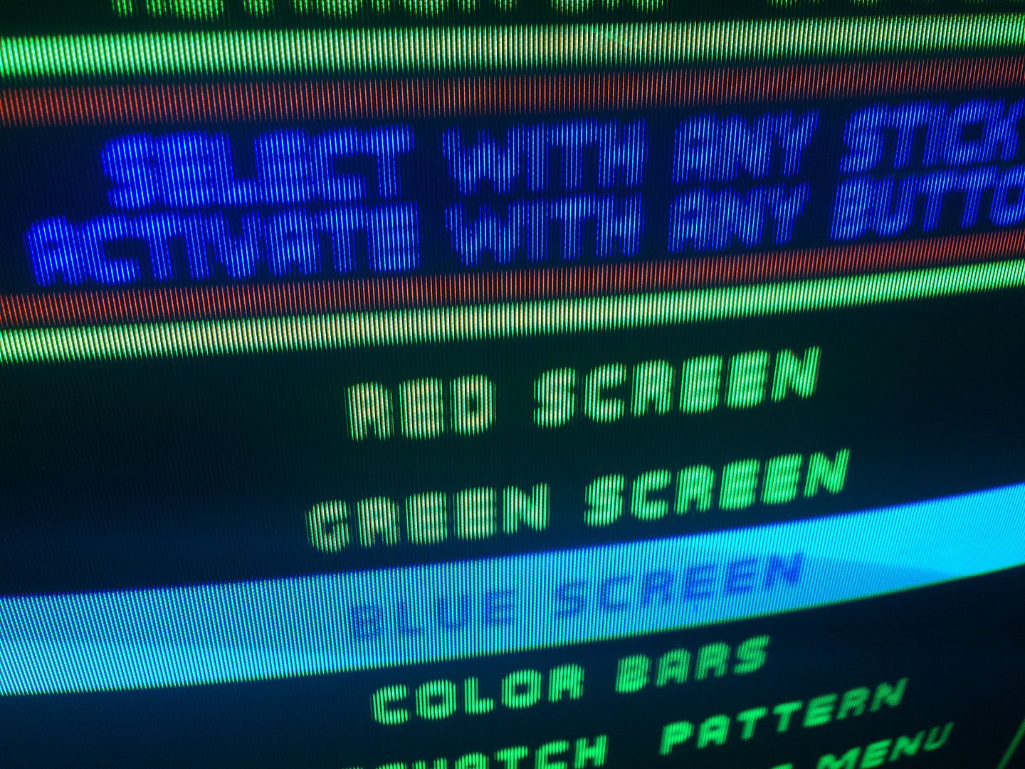

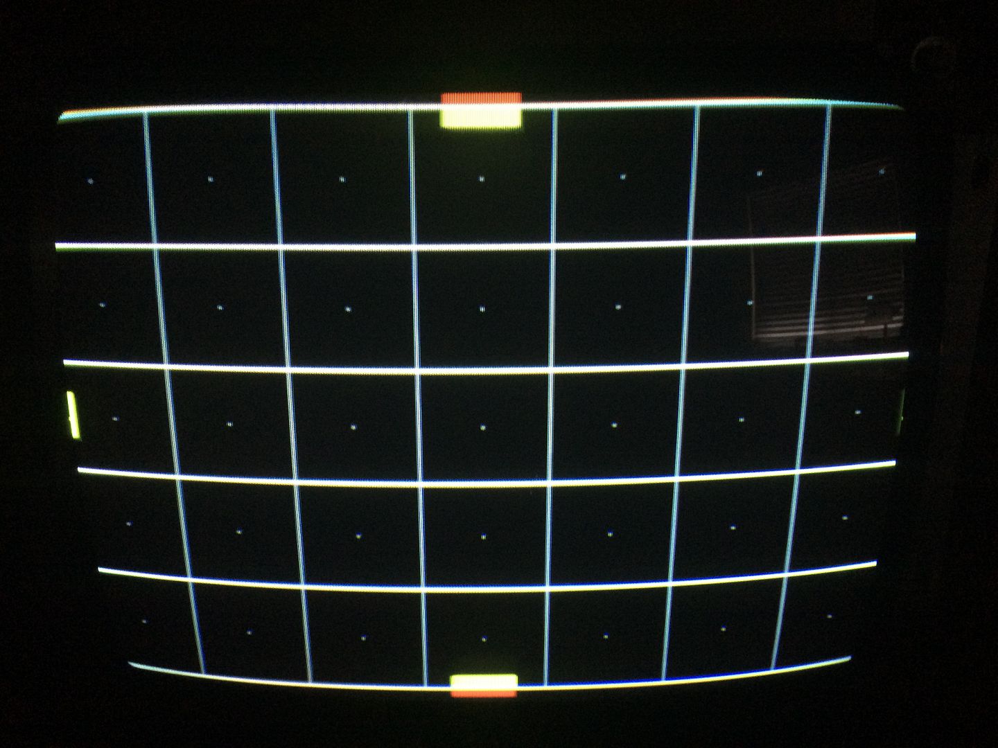

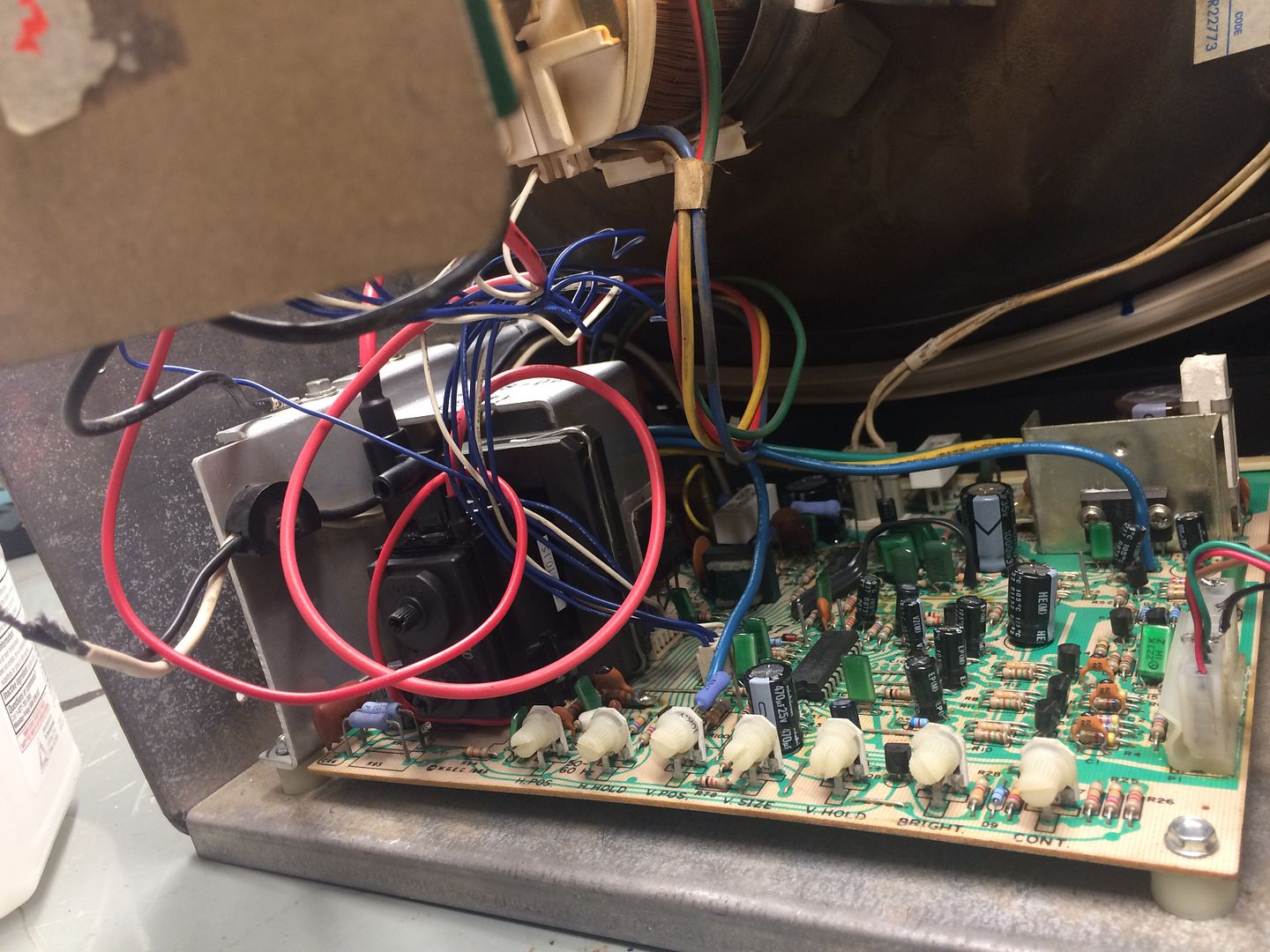

Picked up a couple 19" K7000 tubes recently with no frame or chassis. Tested them both using a spare rebuilt chassis I had. They both worked fine, but were in bad shape regarding degaussing and convergence. I had another tube complete with the frame that had a leak, rendering it useless, so I stole the frame and dropped in one of the new tubes. Installed the chassis and began all the adjustments. Here is a series of before and after images. It's all done and looking great! Now I just need to find another frame and chassis for the other tube...
