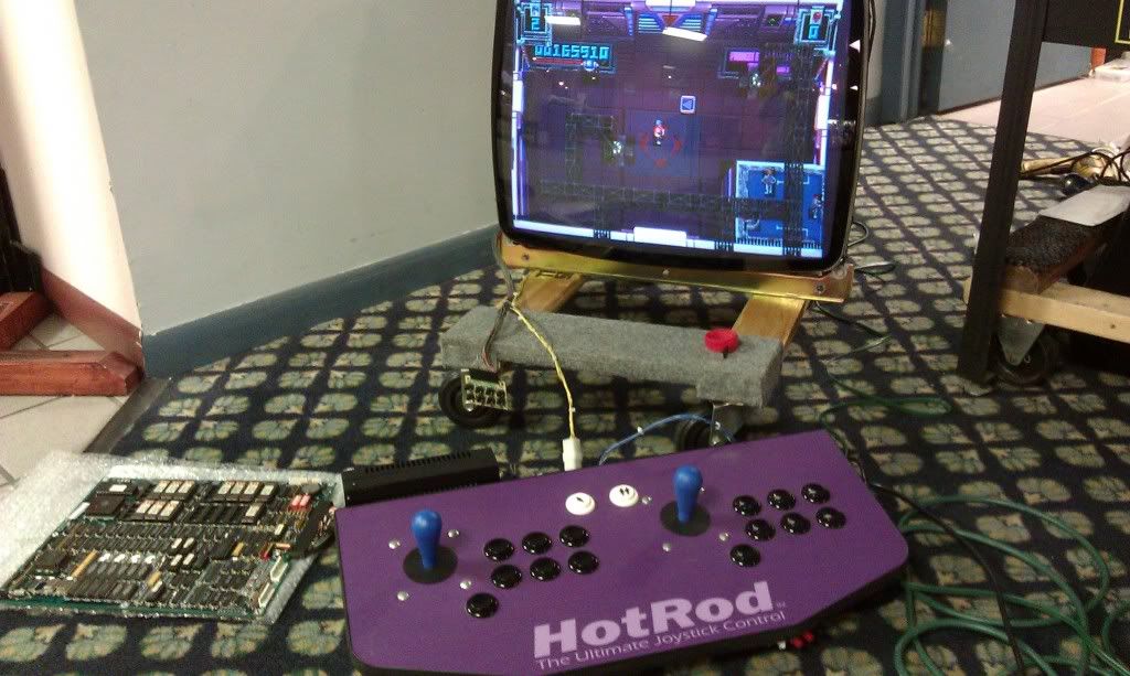

I have a Smash TV board that has numerous graphical glitches, and the game will also lock up to a grey screen after completing the first level. so I will tell you what I've tried with it so far, and share some picture goodness.
another Smash TV board topic suggested that the U99 chip could either be bad or need replacement. I pulled one from my High Impact Football to drop in and there was no change, and likewise, the High Impact board also ran fine, so it wasn't the U99. I also swapped CPUs, no change.
first off, in the picture of the board, while I had the game running I started pushing down on every single IC on the board. I was able to narrow it down to a couple of RAMs I'm guessing between the ROM sockets (circled in red) where if you pushed down on them even gently, the text would clear up and the black lines would go away completely. I inspected the underside of the board a LOT and there was no damage to any traces in that area. the two "RAM" chips I saw had entire halves of their pins where they were barely in the through holes, so I assumed I could just desolder them out and solder them back in flat.
attachment.php
this did not correct the problem, but now I realized I could push down anywhere inside the green box and get the same clearing of the problems. the game's lockup issue also went away. the component side solder joints on all the SR resistor packs (I'm guessing that's what they are) looked a little cracked in several places, so that was my next plan of attack to reflow all the solder going to those.
after doing this, I was no longer able to clear the board up by pressing down on any of the components in the green box. so now I'm back to where I started with no obvious solution available.
what should I try next? channelmanic? anyone?

I'll show off my supergun too, lol

well, as per what channelmanic told me to do, I started probing all the rom sockets and everything checked out. then I started checking resistance on all those SR parts that I resoldered, and one of them... I only got readings on half of it. upon closer inspection, it was cracked in half.
I'm leaning towards this being the cause, I'm thinking before I reflowed it and when I pressed down on the board to clear it up, I was bending the SR back together lol. since I reflowed it so heavy, it wouldn't do it anymore. however, I was able to flex the board to get readings on all the points, then suddenly I got nothing again.
I'm gonna chop one off one of my shitpiece MK boards and I'll check back. won't be for awhile though, gonna be another busy day at work.
I was going to say check those ceramic long caps or w/e they are (don't know the term for those orange/brown hotdog things), good catch. hopefully it's just that :D
All fixed. Well, sorta. I still have the grey screen lock up issue after level 1 though. The reset trick that takes you to the 2nd world however does not have any freezes. Should I redo the game roms next? I lack the pleasure dome lol

yeah, I didn't bother hooking it up cause my supergun presently lacks a speaker for sound anyway. lol
it's not as big as you'd think. the top overhangs the box portion by a lot, and the box itself isn't very deep. you should see how I had to shoehorn everything into it (full JAMMA harness, bunch of rolled up wires I didn't want to cut, my JROK TV encoder and sync cleaner, etc.)
ultimately I think I'm gonna have to use a really small speaker or screw one to the back like I did the power supply with little L-brackets.
I'll have to do a post in the showcase section for it showing what I did. I made a molex plug for hooking into the TV encoder or outputting to a RGB harness for a video game monitor (an extra U5000 I just had rejuved that you see in the one picture). overall I love it, can't wait to take it home sometime. I also have a MK2 style kick harness ran to the bottom buttons.
