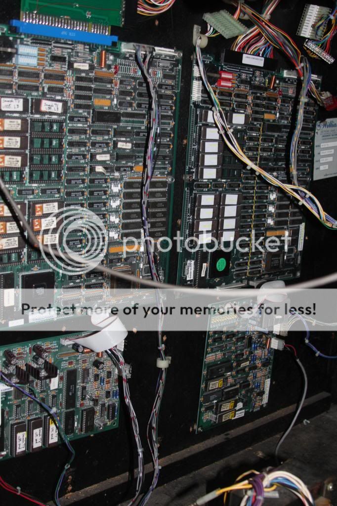

just got my boards back from eldorado but when i put them in my smash 25 cab i got nada so i disconnected the sound board and got all roms good and started playing in mute....if i hook up all molexs i get nothing any ideas....still waiting on mike to mod my 2-1 to jamma +

missing volume pots? can't tell from your pic, they're located at header J2 on smash tv and P4 on total carnage. If you don't have these i can make them up for you but it will be about a week or so until i get more pots in.
i have a volume pot for the smash game and have moved it from board to board...will the game not boot up without it connected?
it'll boot fine without the sound pot or without the soundboard, you said you got no sound tho "playing in mute" your sound pot wiring is 3 wires correct not 2?
a smash tv pot will work on total carnage but a total carnage pot will not work with smash tv unless you add the shield wire.
maybe you hooked the ribbon cable up backwards? (red trace should be at pin 1) when you do a sound test do you get IRQ ok/functional?
power cable to the sound board not correct? I think smash tv power cable is different than nba jam or mk2. I know nba jam and mk2 are different.

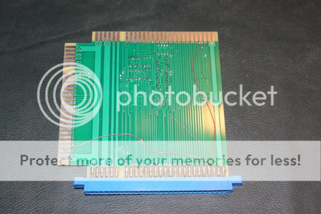

mike is adding a 25/c trace for me--his double jamma does not have one. smash and total use a jamma + set up ...on jamma alone 25/c is listed as nc...not used---after emailing him he didnt even know this was a problem, then after i showed him the pinout he was very willing to help me...i didnt want to hack his harnass up---i still either need to split my volume controls from one pot or add a second..i will most likely add a second and put the volume pots on the service switch mount

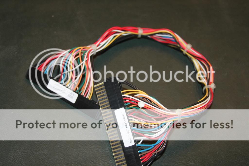

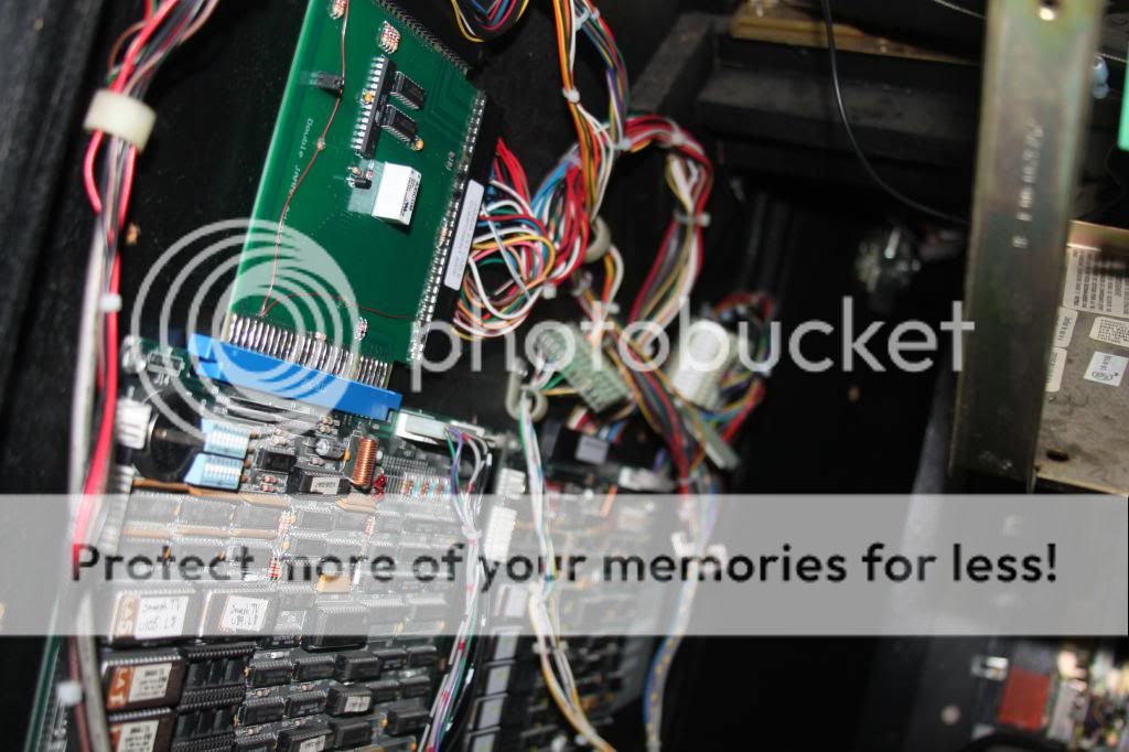

More in my double jamma saga. Mikes board just came back today with the trace wire added.
One problem-I sent him the extender harnass back and he sent it right back without a wire for 25/c---again arggg
Nothing is easy for me.
Here's both boards in the cabinet and mikes above them
So after I hook them up...nothing. As I suspected mikes board dropped my 5v at the main boards. After checking my 5v dropped all the way to 4.4. So after slowing upping my volts I was able to get both boards to work at about 4.9
Then after testing them, my smash board worked fine with its new wiring...little loud with only that one pot and total worked but no right action and hard to hear. Volume pot is going to be added later
