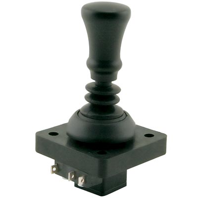

Hello,
I am wondering if anyone knows of any small sized joysticks and/or trackballs that would work in a Nintendo Counter top cab? I got the cab for my wife from a warehouse visit we did recently and she wants me to put a 60n1 into it, but asked me if i could get a small joystick and trackball for it due to its size and her small hands.
I have looked around on the net, but so far couldn't find what i was needing.
Any help would be appreciated.
Thank you.

There are of course the original joysticks for a PC-10 counter top machine (link) which are tiny. The 25mm balltop joysticks used in Nintendo cocktail machines are small enough to work as well; a standard VS. or PC-10 upright joystick is probably small enough to work too.
Happ makes a 1 1/2" trackball (link) but it isn't cheap by any means. If you want smaller and cheaper you'd probably have to hack one of those trackball mice:

For joysticks, I wonder if these would work:
http://na.suzohapp.com/joysticks/50275500.htm
It is a subminiature joystick sold by Happ. I can't find the dimensions, but it looks tiny and reminiscent of the ones on the Playchoice countertop.

Back in the 80s, I used an Epyx 500XJ joystick to build a small custom controller that I needed to beat a game. If I remember correctly it had the nicest little joystick with four switches. I still have the original around here somewhere. I'll look for it later and post some pics and measurements. It should work great for a mini arcade game.
