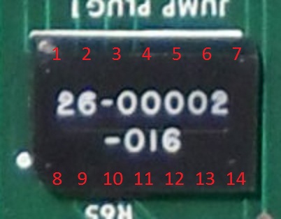

I'm going to try to hand-wire my own Slither DSR board to try to convert a Qix set, most of it looks pretty straight forward but on the schematics are two "jump plugs" for selecting the type of EPROMs from 2716 and 2732. I'm not an electronics genius by any means so I was wondering if these are as they sound and are simply just straight through jumpers? If so can anyone tell me what their configuration is as the schematics don't show which pin jumps to which? I find it a little hard to believe that this board, the only part keeping a Qix set from being a Slither, is simply made of off-the-shelf parts with no design protection against what I'm trying to do, but thus far everything I've seen seems to indicate that.
The purpose of the jumpers is to select between the use of 2716 or 2732 EPROM's on the DSR and video boards, respectively.
26-00002-016 jump plug is used if 2716 EPROM's are used and 26-00002-032 jump plug is used if 2732 EPROM's are used. How they are internally wired to do this I do not know, but would have thought someone knowledgeable could tell from the schematic.
I can probably bumble my way through the problem eventually, I was just hoping someone might have some ready insights into it.
Okay, after taking an ohmmeter to the plug:
If you number the pins like this:
the connections are as follows:
1-8
2-9
3-10
4-11
5-12
6, 7, 13, and 14 are dead. They don't connect to any other pin.
Whatever sense that makes.

Thanks for the information. However, how one identifies the pins is actually irrelevant to the information being provided.
The connections I found by testing are accurately reflected, given the designations labeled in the picture. (Which, as Hewitson points out, may well not be the standard.)

Man you're awesome! Those pictures you took for me too are invaluable, I'm taking the schematics from the manual, cleaning them up and using the pics to compare anything that's tough to read. Here's some of the work I've done so far with the video EPROMs, there's still a lot I'm going to have to trace or figure out. BTW given what you've shown with the JP1 connections I'm surprised they just didn't use a dipswitch, which is what I'll probably put, why make a weird custom part?
