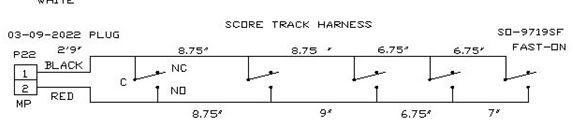

So I finally started looking at my Skeeball model S machine again after quite a while not touching it. It still has a problem with the ball count, but there's been some progress. It turns out I had the switches in the ball trough wired wrong...the manual shows them as being on common and normally closed instead of normally open like I would think. After doing this nothing seemed to change until JoshBrown80 was messing with the molex plug for the ball trough. When it was unplugged it would then count up whatever switches we tripped and play the game over tune....that definitely seems like some kind of a board problem, hopefully a minor one....it's like something in the ball count circuit is "stuck" on the cpu board and works when the wiring to the ball trough is disconnected. Any thoughts?

Apparently you guys haven't worked on one in a while. I was working on one just last week, and I can assure you that the switches are normally closed, and open to score 10 pts. In fact, they are daisy-chained, so that any open switch scores the same 10 pts. 3 opens in a row will score 30 pts.
Even the wiring diagram shows they are NC:
Now, if you are getting NO scoring at all, then look at the connector or the board. if you are getting missed scoring (i.e. 40-pts only scores 30), then look to your wire adjustments. I had to bend the new wires out and then down 90-degrees to make sure they registered properly every time...

The switches ARE normally open. If you look at the wiring diagram, one wire goes to the common, and the other goes to the NO contact. When the switch is at rest, common is connected to the NC contact, and when the switch actuates, common connects to the NO contact, thereby triggering the score.

That wiring diagram is showing the switches in the resting position (COM and N/C connected). Look at where the red wire is connected to each switch (N/O) and where the black wire is connected (C). If all the switches in a single circuit were wired C-->N/C and one of them opened how would the logic know that one of 4 switches was open?
The switches are supposed to be wired COM and N/O. That way when a switch closes it pulses the signal to COM at the logic board and it gives you 10 points.

See, I read that schematic like this: when the switch tab connected to center moves from the NC position to the NO position, it completes the circuit and registers 10 points. I get what your reasoning is, but when compared to the way a normal control panel game button works, the switch goes from NO to NC (or center) which is opposite the way this is working. Now, just because there is no wire connected to NC does not mean that the switch isn't in the NC position, and moves to the NO position to score. I think we've just worded it differently, but mean the same thing.
I worked on one recently that I put my meter on the wired lugs, and got a continuity signal. When triggered, that switch went open and scored 10-pts. The machine scored just fine.

I worked at Skeeball handling all of the repairs on the PCB's for 4 years. The switches are wired Normally Open on the scoring section. The ball count switch is wired for both normally open and normally closed. (has all 3 terminals wired on the switch) Check the wiring on that switch.

That's weird. I'm not discounting you especially since you've worked for Skeeball, but the manual does look like it shows them as wired to normally closed as Mod said. Weird. :confused: Oh well. I might as well properly attach the wiring for that ball count switch just to eliminate that as a possible variable.
That is NOT was the manual is showing you.
It is showing the "switch" in the Normally Closed "position".
The wires are actually connected to the Normally Open and the Common terminals.
Black going to "C".
Red going to "NO".
That is for the scoring switches.
The ball count switch has -
Black going to "C".
Red going to "NO".
Green going to "NC".
Make sure you have continuity between the Black and Green when the switch is at rest. (not activated)
And between Black and Red when a ball activates it. (not just by hand, check with a ball resting on the switch)
I can't explain Mod's findings, but I would ask that he took a second look at it, because technically it should not count if even one switch is wired C and NC. It would be like having a direct short, there's would be no "off/on" action for the system to "count", it would be stuck "on".

Hmm okay had a "duh" moment looking at the wiring again. I realized the switches were all wire backwards with common to the normally open and vice versa. Instead of a black wire it's actually white for the common loop after the first switch so maybe someone messed with the wiring at one point. Anyway, I fixed the ghetto rig on the ball count switch and moved things around to their proper location and still no joy. I plan to take another look at the wiring tomorrow to make sure it's correct, but I think I've got it now. That's the second time the last few days that I thought I had the problem figured out too. Bah.
Try disconnecting ALL of the switches and touch the two wires that would go to the first switch together and see if you get anything. I'm pretty sure that you have already changed the switches but just because they are new that doesn't mean that they are good. If one of them is internally stuck closed none of the other switches will do anything.
Also, while you have the wires removed from the switches check them for +5 and GND. You should be able to measure close to +5 across the switch wires using a meter. If you have it there then the wires are at least connected to the logic board. If you dont then you either have a bad GND or signal (score, points whatever you want to call it) wire.
