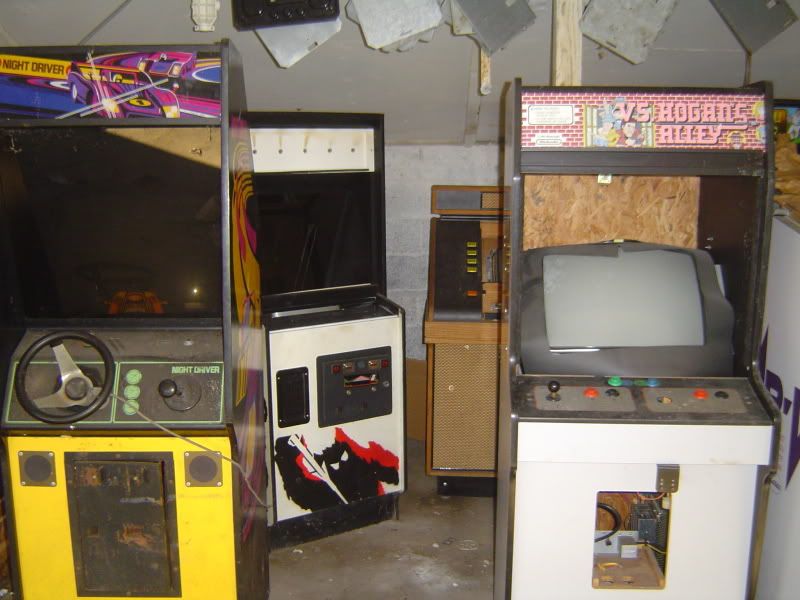

Not by my machine right now and I want to order some t-molding for my PC-10.
What size is it? 3/4"? It's definitely thicker then the rest of my Nintys.
I am also thinking of putting white on it. What do you think??? :)

It's 5/8" white.
Yes i like the white look much better. im not sure if mine need to be replaced or not but if it does id replace it with white.

It's not 5/8! It's 5/8 offset so it will not look correct if you change it out. tmolding.com used to have some offset but they are out. You would have to use 3/4 and then cut off the extra with an exacto knife. If your t-molding isn't horrible leave it as is.
Is it really offset? That groove looks pretty centered to me. Hrm...
