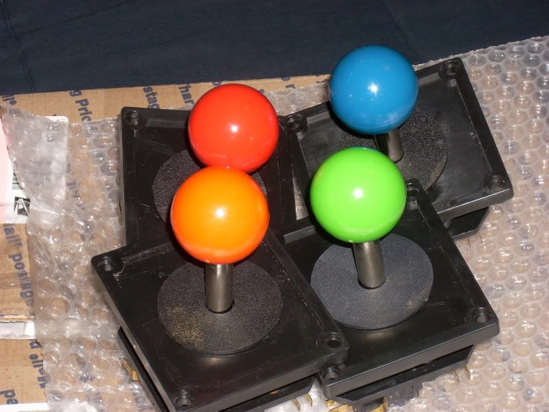

I found some NOS Wico joysticks on eBay last week and they arrived yesterday. They look very nice overall and should bring a more authentic look to the cab than using Happ joysticks. I still need to place an order with Bob to get new buttons and a few molex connectors and then I can finish up the entire cabinet wiring which is the biggest task left other than purchasing and applying side art. The coin doors and vaults have also been re-installed on the cab. There are a few wires hacked on them, but nothing a little solder and heat shrink tubing can't clean up.

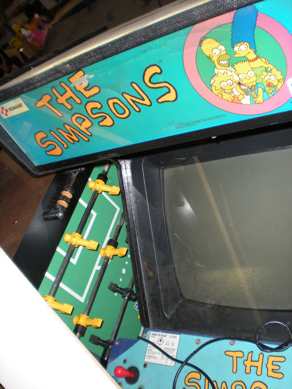

Too bad you are not near NY you could have bought this cheap:
Yeah but then I'd miss out on the fun of restoring this one and bringing it back from conversion hell. :) Still as I've said earlier I probably wouldn't have done this full restore if the side art had been salvageable. It has been fun though.
