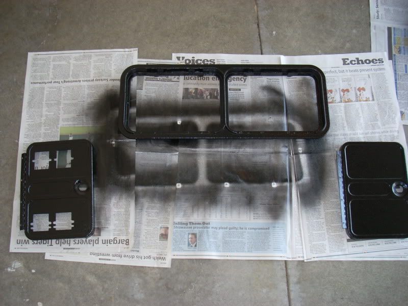

A few more pics of the coin door work. We used this paint made for appliances so it's supposed to be more durable. I think the doors turned out great and yes they are supposed to have that orange peel looking texture to them. :)
Before
After

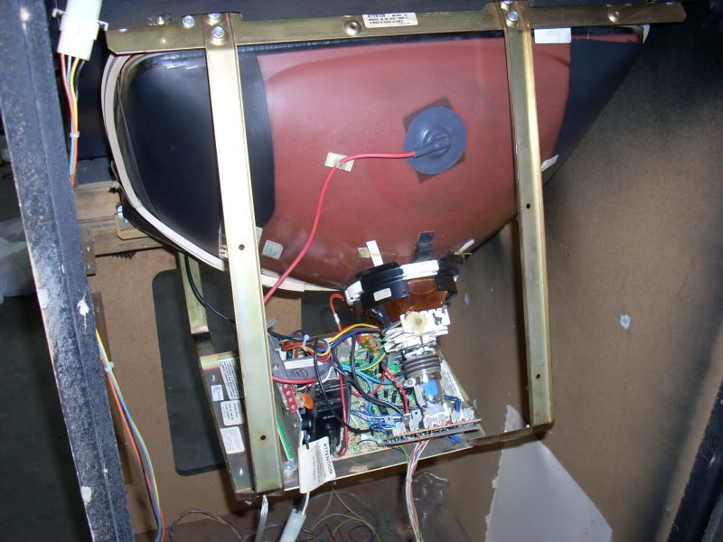

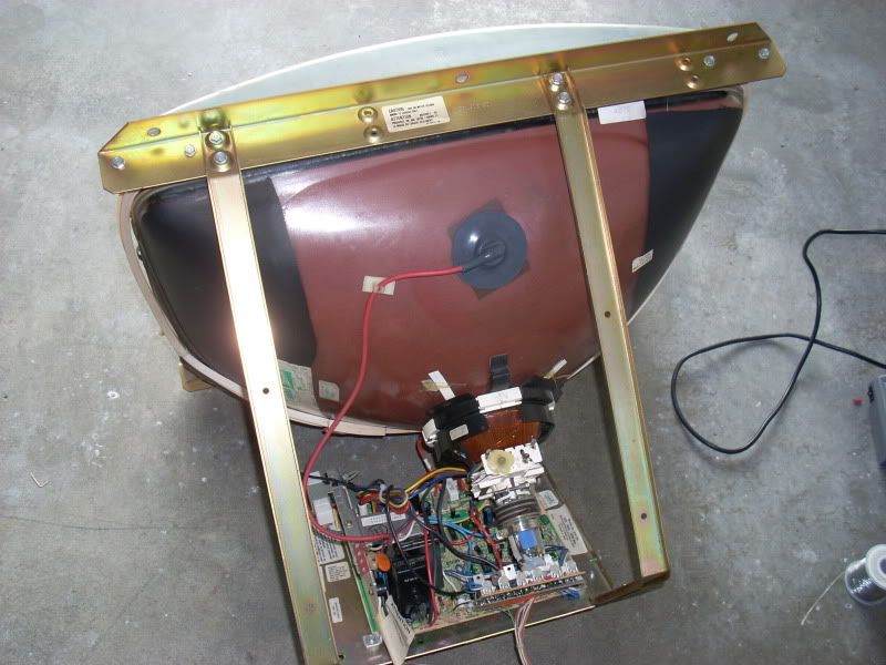

Bump for some more work done today. First Josh and I discovered the red overspray by the speaker grills would come off with Simple Green! Woohoo! Next we decided to tackle the monitor which works, but it was pretty dirty and since we took it out to clean, we threw in a cap kit. While doing the cap kit a few of the old caps even hissed a bit when their legs were heated up. This thing hadn't even been touched before so it was neat to be the first guys to work on it and clean it up. I forgot to take any before pics, but the monitor was pretty dirty. I think the after pics speak for themselves. No, it's not a new monitor hehe.

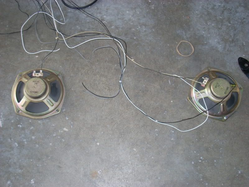

Our next task for today was repairing the speaker wiring. It had been hacked of course, but luckily I still had a spare 4 pin connector used by many Konami games of that vintage for stereo sound hookup. We wired the speakers up with new wiring and even took the time to bundle them close to how the originals had been. This is an in progress shot as we were soldering on the new wires. The speakers are now re-mounted with freshly painted grills and the spare connector has been wired in.
Whoa that monitor looks nice and sparkling. After wrestling with a Sanyo, that one looks like an uncomplicated drink of cool water to work on. I loved playing the Simpson's when I was a kid, so keep up the good work.
Yeah the monitor turned out really really really good. We have cleaned numerous monitors, but somethin about this one just popped and made it look amazing....so cool!

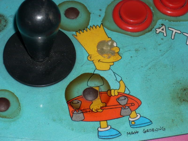

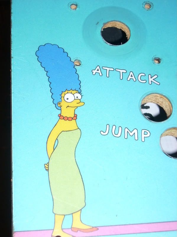

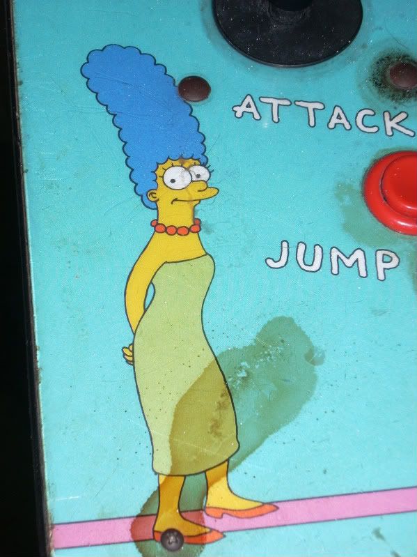

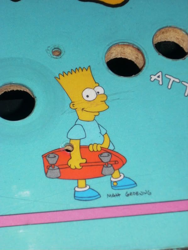

Like a kid on Christmas, I anxiously opened a package containing a control panel courtesy of Steve23. A nice surprise on an unusual day off of work. :) Here's a few before pics and you can see the overlay is in pretty good shape other than the small piece missing from the lower right hand corner. Looks like some pop was spilled on this thing at one point and I was able to push on the plexiglass to see the pop is still wet (gross) so hopefully the cpo will clean up really well. The "after" pics will follow hopefully later this evening.
Okay we took the CP apart and cleaned the hell out of it. I'm going to get some new sticks and buttons, but will keep this overlay in tact for now. Anyway, it's looking A LOT better without that pop on there. The plexi is still scratched up but I put back on temporarily. It will be replaced and I probably should have taken these after pics without the plexi on there, but oh well. You can see a dramatic difference without the paint and pop syrup. The plexi even had some nail polish on top of it, which is what was covering up Bart's head in the post above. Looks like someone else tried to remove it by scraping it based on the scratch on the plexi. Josh realized it appeared to be nail polish and luckily nail polish remover took it off. The nail polish remover also took off some black paint of some kind that had splattered near the top of the cpo. We were careful when applying the nail polish remover directly to uncovered cpo, but it turned out not to harm it and after a little agitating with a toothbrush, the paint came off. Overall I'm very pleased with the results in cleaning up the CP, even though it has that small missing piece, I can live with it for now.
