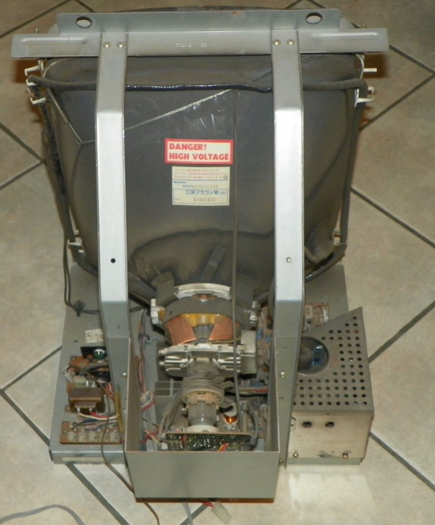

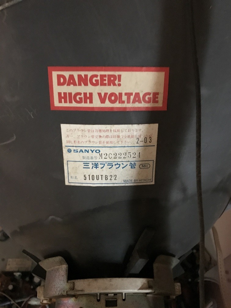

i got a monitor from a DK Jr. the tube says Sanyo, so i'm guessing it's a 20EZ but how would i know definitely? i wanna make sure i get the right cap kit. thx
many ways: google image search, arcade manuals (physical or pdf), klov, experience, etc...

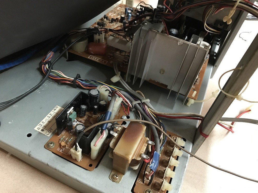

that should be your standard 20ezv cap kit. if you need them i stock them with the audio kit included.
BTW: if you ever have a question trying to ID a chassis feel free to shoot me a picture as i would be happy to help. i do have some pictures on my site (clean high res chassis pictures so you can zoom in and read the location numbers) they also include the component and solder side pictures.
PS: don't forget there is one screw that has to be removed from under the frame over on the flyback side.
B+ pot replace it if its original too which i stock if you need.
