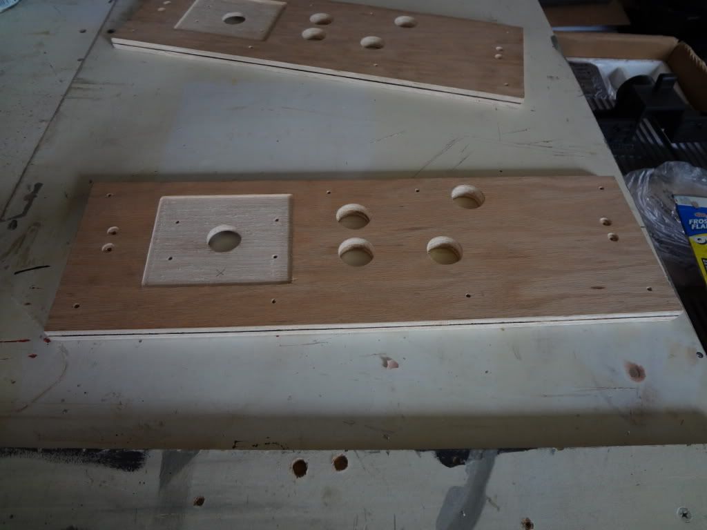

I dropped these in the mail to you today, the expected delivery date is Monday. The top is my original for comparison. I will leave all the finishing/painting to you:
Bottom:
Top:
On cabinet:
With overlay and buttons installed:
Holy shit Tighe, nice work. Let me know what I owe you kind sir. Kick ass!
Thanks Phet! I enjoyed making them! I had to pull the panel apart to clean and polish the joystick on mine anyway.
If you wanted to do something for me if you had a spare set of monitor mounting bars for a Galaxian/Galaga/Ms. Pac I could use a set. But don't go out of your way.

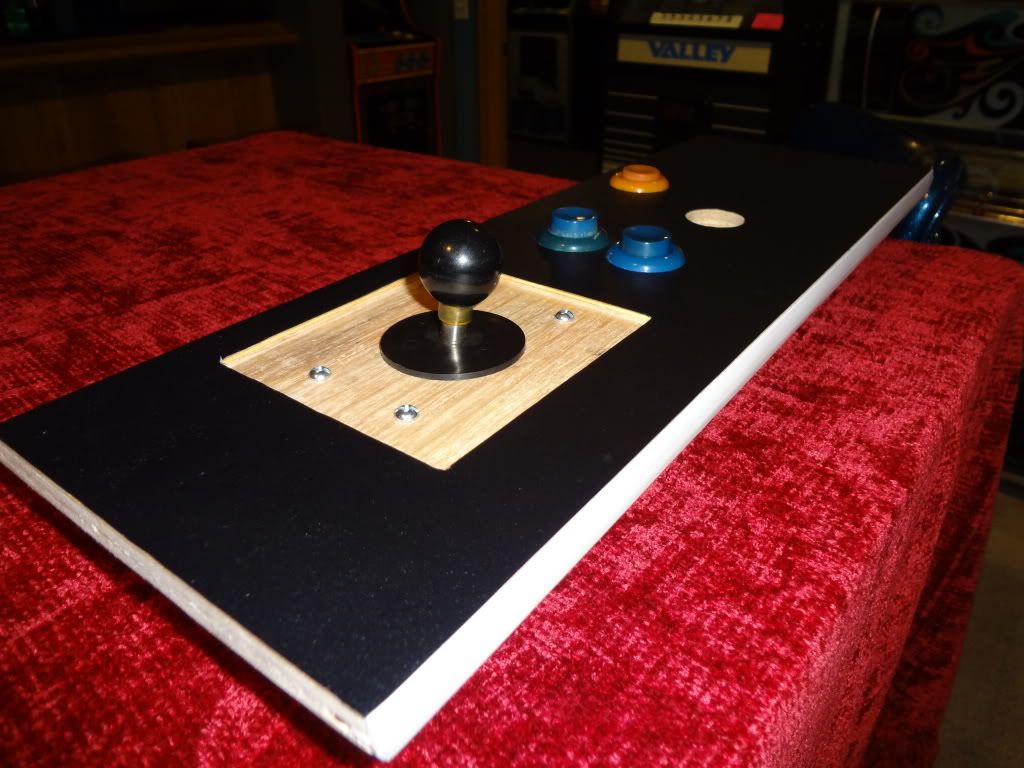

So I got one of Tighe's CP blanks sanded, sealed and vinyled over the last 2 days. I installed 9/16" T-molding and will now vectorize the CP and have that printed to go along with a piece of lexan I plan to route to shape using one of these wooden blanks as a pattern. I test fit buttons and joysticks, but will need to find a source for more of the wooden cp hardware, as I am short latch clips, button/micro assemblies with the roller arm, small carriage bolts and some 4 way restrictor plates for the vs. Joysticks I will be using. If anyone has extra CP hardware to sell, PM me. Tighe, thanks again for doing these blanks for me, very impressive work.

Phet! That looks awesome! Great job!!!
If you look at my original panel there is a metal mounting plate that mounts on the top and has bolts that go through the panel for the joystick holes --- You did say that you test fit the joystick -- I don't know if that plate is necessary, is that something you can buy? Or should I see if can make replicas of them?

I don't know about how the space firebird panel is made, but you should put vinyl on the angled top of the panel too as it is exposed on the cabaret when it is assembled.

You mean the back angled edge? What does yours have on it? Paint, laminate? I figured it should be bare, wasn't real sure. I can get you a box of buttons if you really wanna clean them up for me. I owe you big time.
Good point! The angled part is has what looks like dark black laquer. The top has glossy black laminate. So you would be right in not putting vinyl there. I would suggest black stain with poly, or black paint.

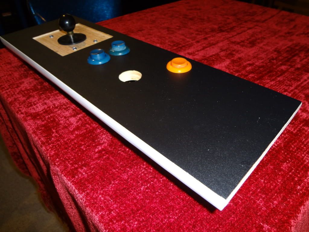

I will post some better photos of my panel here tonight or tomorrow.

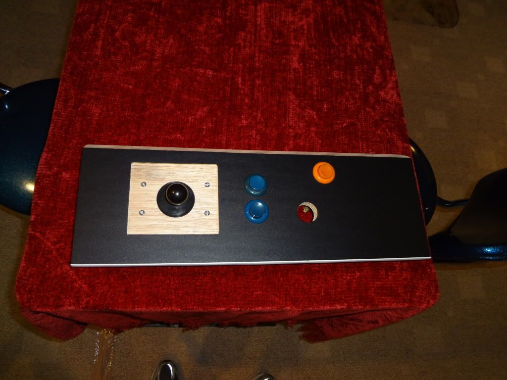

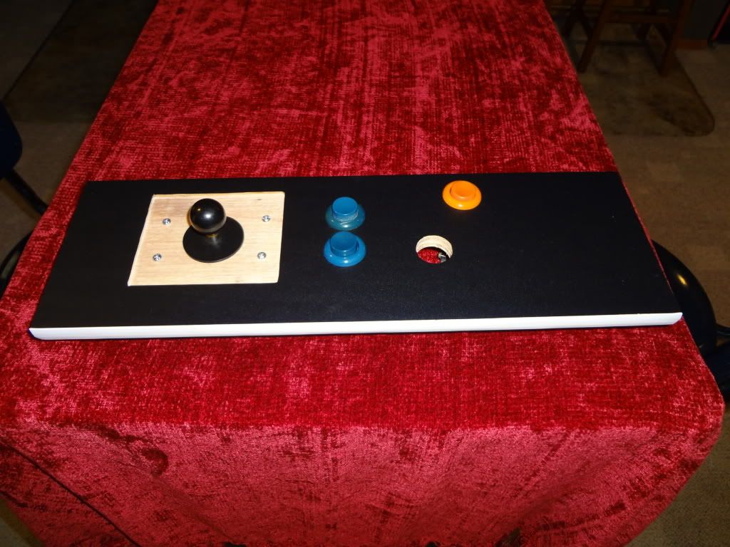

phet, that control panel looks gorgeous. i have to ask, what is the fourth button hole for? i see that tighe's panel has the same hole, so was that a factory thing? weird.
I will answer that, yes it is factory, Nintendo must have used the same panel (or planned to) for other cabaret games. I made an exact copy of my panel extra unused button hole and all.
It would be interesting to see if all the DK cabaret panels had that hole. I can tell it was never used because there is no wear in the hole like the others, and there is no screw hole on the back for the switch holder.

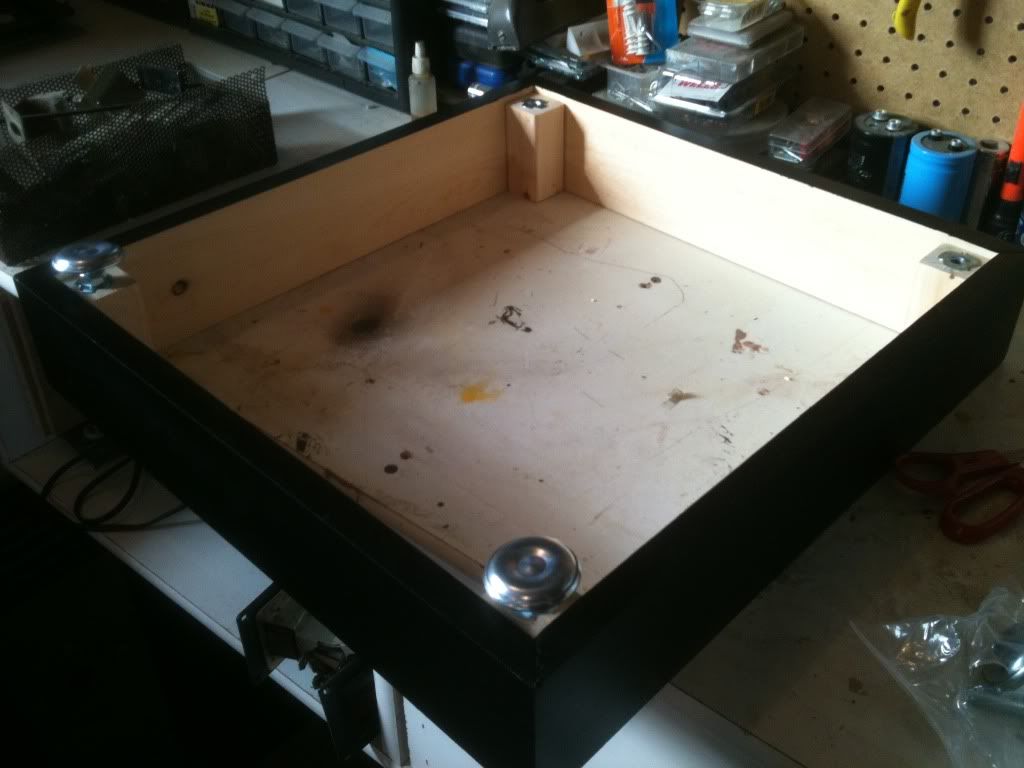

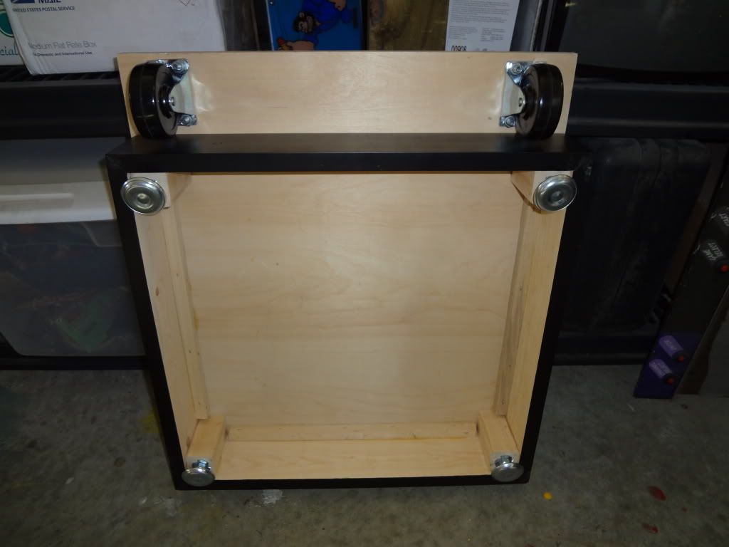

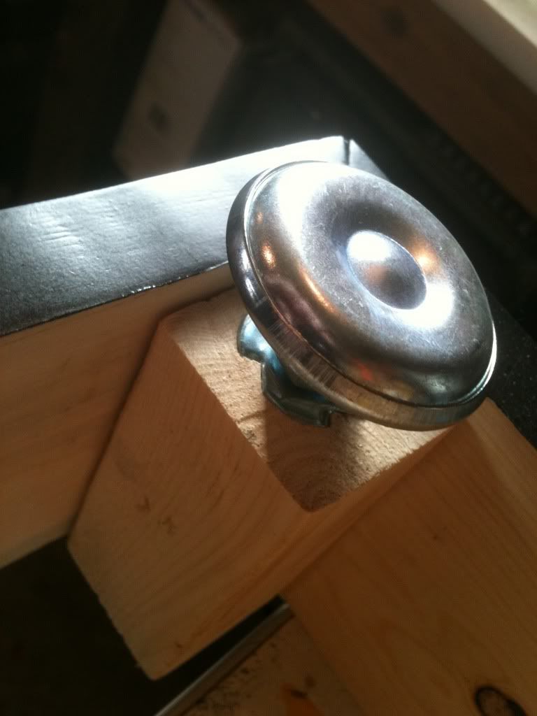

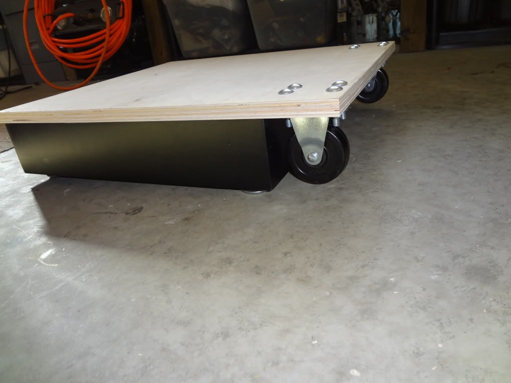

Exciting!! I like that you installed leg levelers!

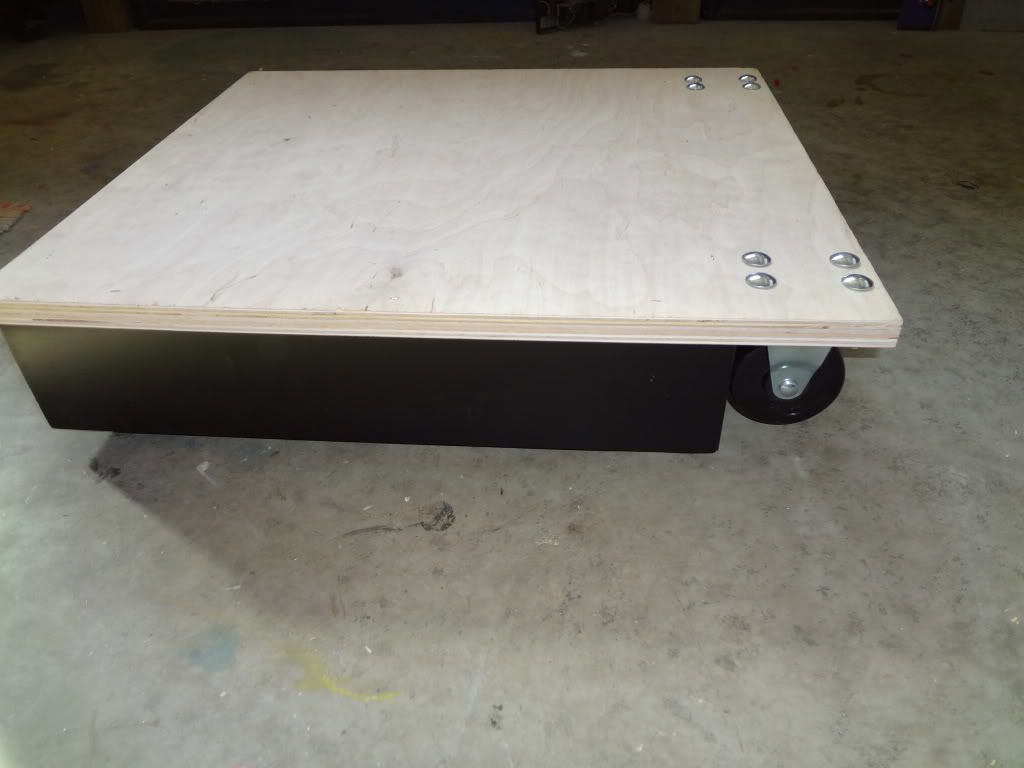

I will be installing magic sliders too, as this machine will be sitting in an area where it will need to be moved to the side every once in a while. I just wanna be able to quick slide it out and back when needed.
Base and floor completed. Now I can finally start building the insides and then attach the outsides. This is going to be a slow project with updates as I have time to get them done.
